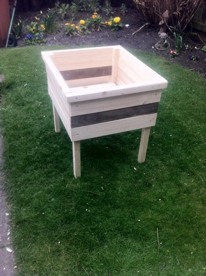

First time I have ever set my hands on a mitre saw and built myself something. This is the beginning....
NOTE: I did get the middle wood panel the other way around so the pictures shows a dark piece of wood
(I turned it around after the pic to match the reset of the wood).
I do need to stain and protect it.
1 hour build time and 3 cup of teas... YEY!
Very good, hexagonal shape is a good one for planters.
Need several coats of a good exterior wood preservative, & few drainage holes in the base.
One tip, mitre the corners, looks smarter than showing end grain, & top rim again mitre corners & screw from inside.
And treat yourself to a screw counterbore set, & plug cutter set. then you can show off by gluing in wooden plugs over screws, plus you can buy garden planter liners in various sizes to fit planters.

Thanks for the tips guys. Will put them to good use on my next adventure. I am seeking ideas.

For that planter ! BNQ - £6.50 for wood, I used my parents mitre saw and screws cost me £3.00 for a box! so less than a £10er to build!!! Bargain!
Got to stain it too so that will be around £3.00 to £8.00. But overall not bad considering I can't find them cheaper for under £20.00!

If you are seriously looking at it as a hobby, best to go down local timber or builders merchants, be much cheaper.
Great little idea though.
Paint it in creocote and get an old cup and fill 1\2 full and stand each leg bottom in the cup for a day.
I'd use tanalised next time and wouldn't bother treating.
I seen planters made from timber decking, either softwood or hardwood looked good with the grooves.
Old trick of mine is to drill a hole 9mm-12mm diameter to a depth of 150mm or so in a leg & fill with preservative & glue in a plug.
Also done this with fence post, using a larger hole.
