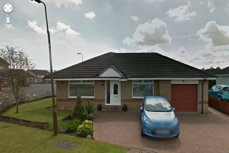

After reading other forum members build/renovation threads I've been inspired to document the renovation of my bungalow that I purchased in November 2013. This will be different renovation project than others featured on the forum, as the main goal of this build will be to create an accessible home as I'm a wheelchair user.
A Little Bit About Me....
Nine years ago I suffered a Spinal Injury when broke my neck in a freak accident, which resulted in me becoming tetraplegic and a wheelchair user. I was in hospital for 11 months recovering from this event. I was still living at home, but was on the verge of moving out. I made the decision early on in my recovery, that I wanted to live as independent life as possible. To that end my separated parents managed to purchase a new build ground floor flat in a development close by to where my Mum and I where already living. With the help of my Local Authority funding was secured to adapt the property to suit my needs - Ceiling Track Hoist, Wet Floor Shower etc.
I have now reached the point that I now longer want to live in a communal building, some people aren't respectful of the building fabric and the communal factor responsible for the building maintenance is useless!
The New Property
In October 2012, I lost my Sister very suddenly. It was the worst moment of my life, being told you'll never walk again takes some beating. This heartbreaking ordeal has given me an opportunity to purchase a forever home, something I would hope my sister would approve of and would make her happy seeing me settled and happy :)
After a short search I found my ideal property in October 2013, less than a 5min drive from my current flat. I put in an offer which was accepted and in November I got the keys.
The bungalow is in move-in condition, however it isn't particularly wheelchair friendly currently in it's current state ;)

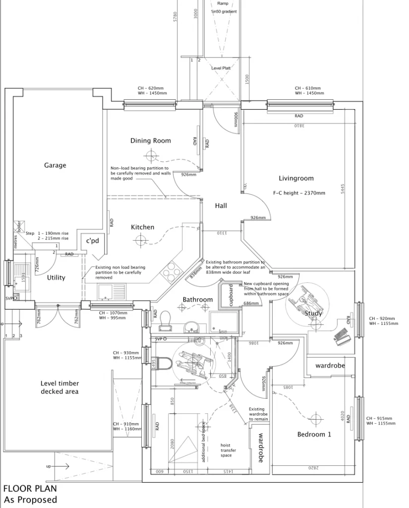

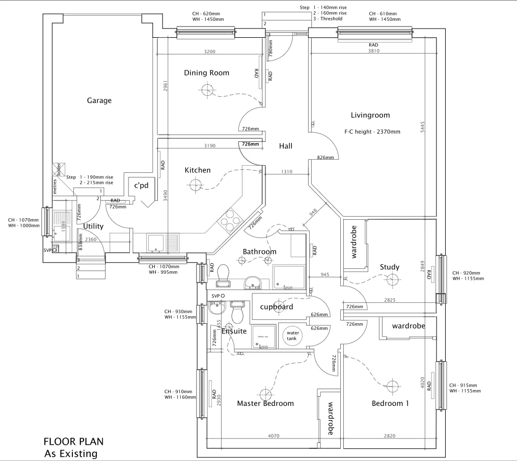

The Grand Plan
With the help of my Local Authority Occupational Therapy Department and a local architects firm I have been working with them to come up with a layout that works for wheelchair use.
My Local Authority will provide grant funding to help adapt the bungalow to suit my basic needs:
  • One point of Ramped Access
  • Access to the Property - Front Door Adaption: New wider and low threshold door along with door entry and automatic door opener system
  • Widening of certain Internal Doors crucial to daily living
  • Showering Facilities - Basic Wet room
I will be funding the rest of the adaptions and layout changes myself as well as adding to the supplied funding to get the finish I would like.
There are several layout changes, with the biggest being the removal of the stud walls between the Dining Room and Kitchen along with the Kitchen and Utility to make a large unified space, and the installation of low threshold French doors out onto a raised deck with garden access ramp.

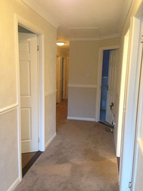

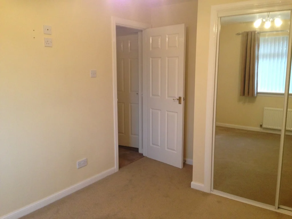

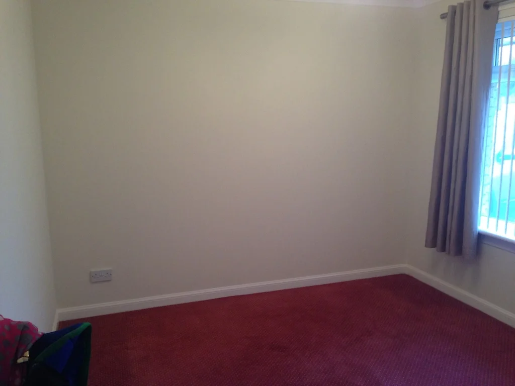

A few photos of the main rooms as they currently stand.

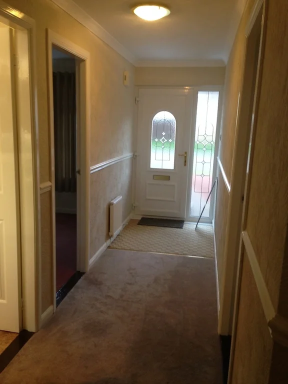

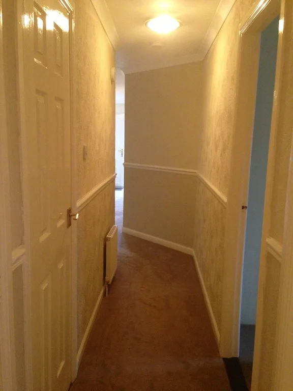

Hall

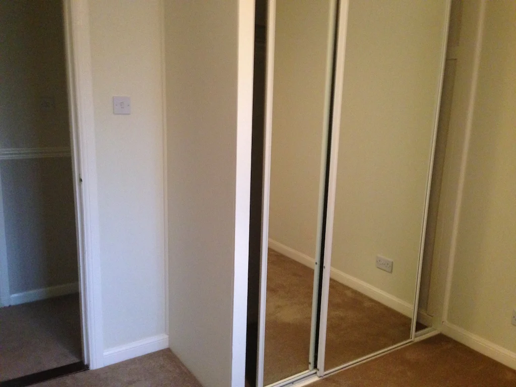

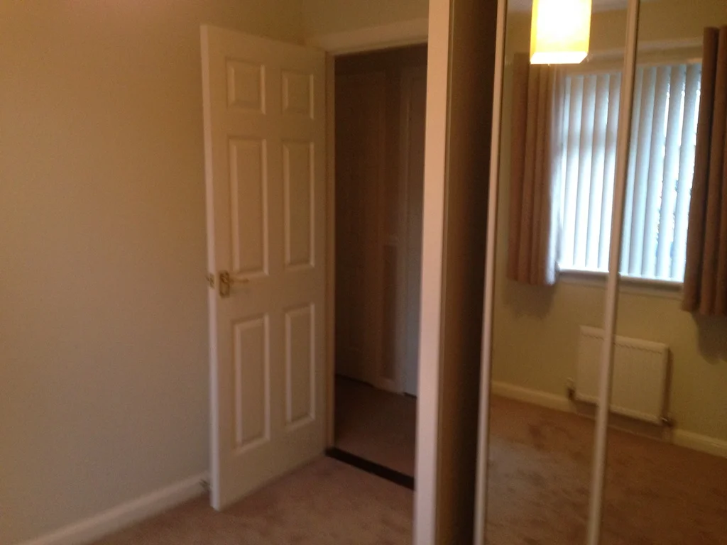

Master Bedroom

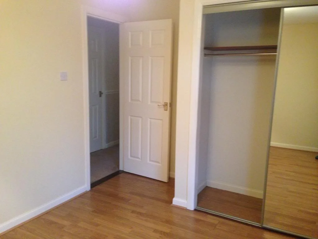

Bedroom One

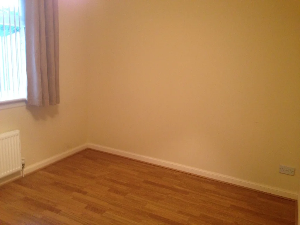

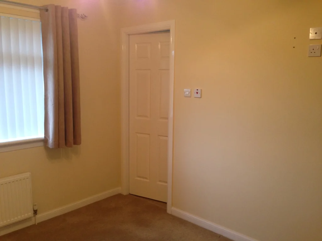

Study

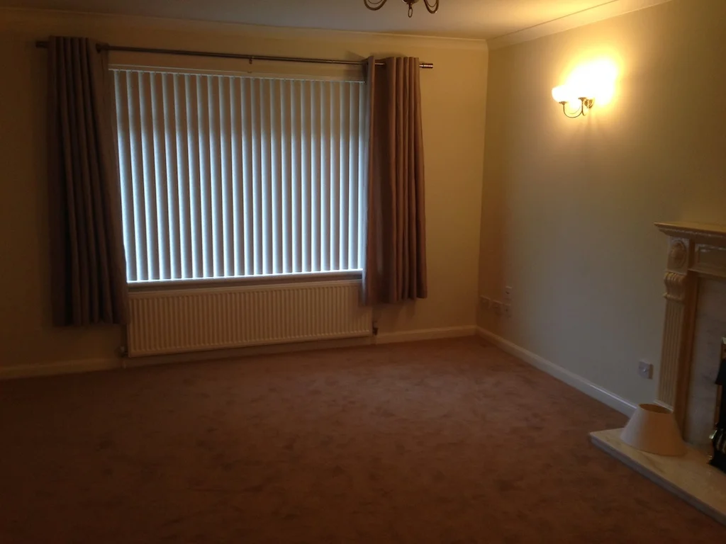

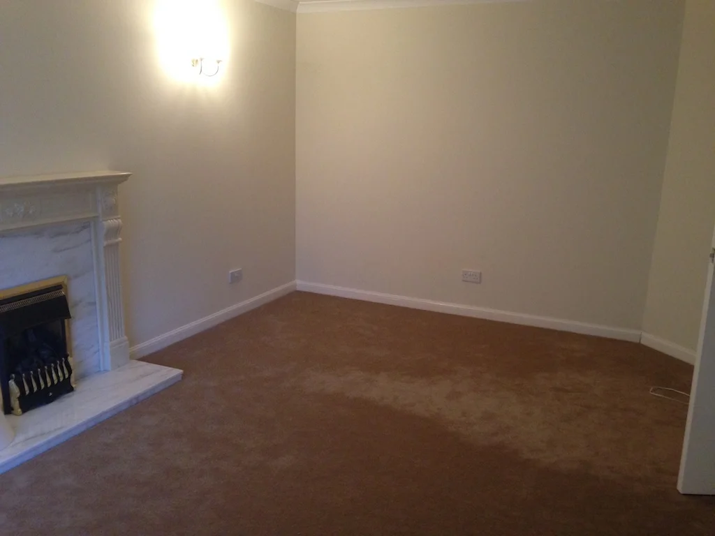

Livingroom

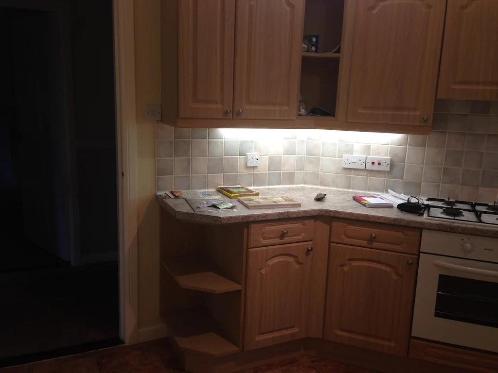

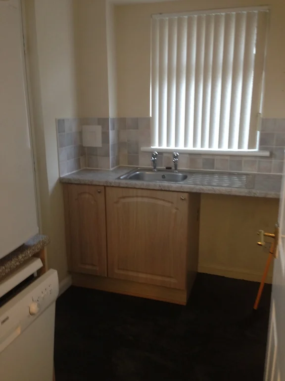

Kitchen

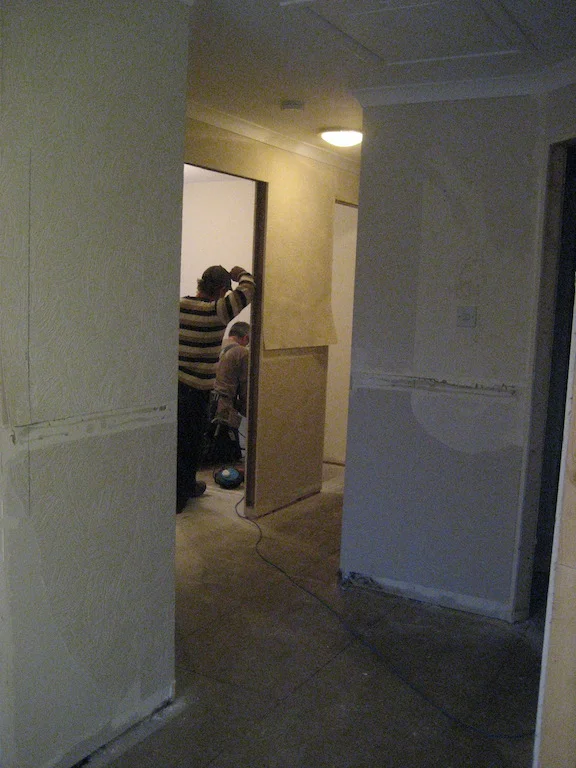

It's been a busy few days. My joiner (Dougy) has really got stuck in, he started on Wednesday, last week (19th February)
Jobs Done So Far...
  • Removed the stud wall between the Kitchen and Dining room
  • Taken off all the old doors
  • Widened the existing doorways to accommodate wheelchair access
  • Removed the mirrored wardrobe from the room that'll be my office/study/computer room
  • Knocked the new doorway into my office/study/computer room.
  • Removed the old door surrounds and dado rail
  • Gutted hall and airing cupboard in preparation to knock through into en-suite

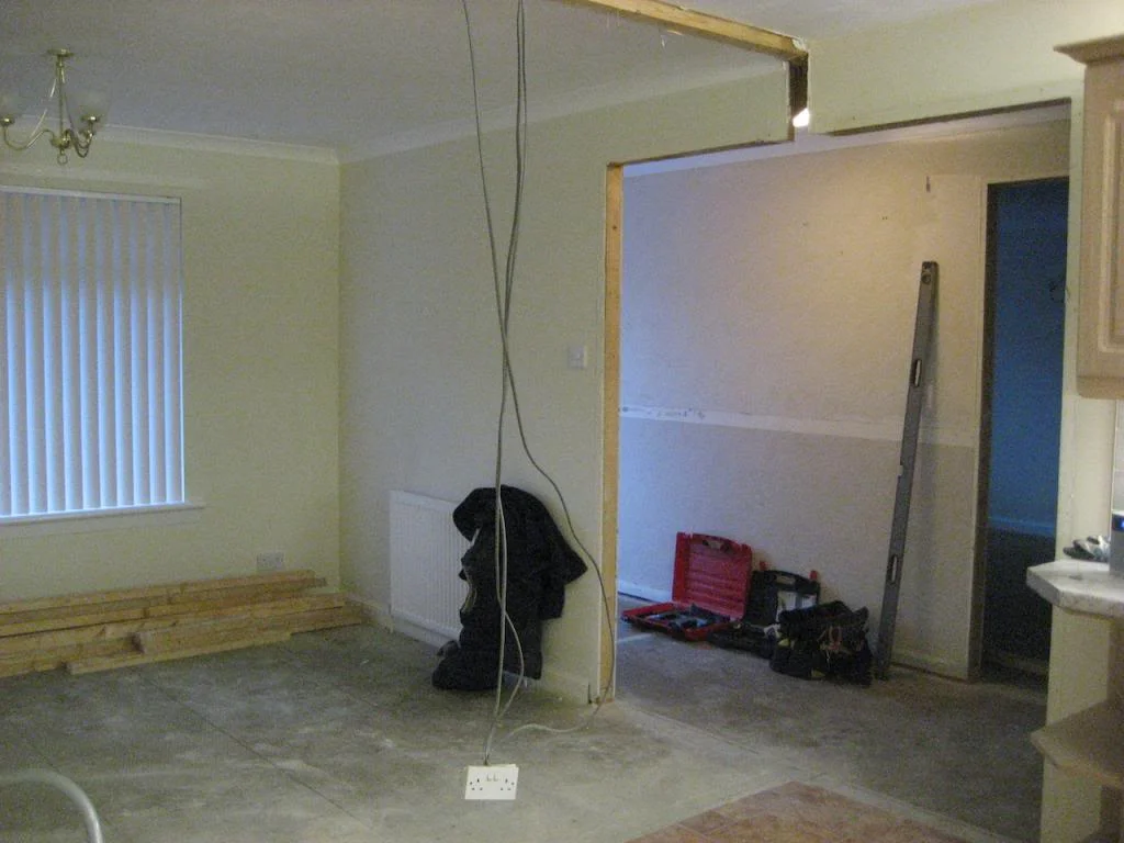

Couple of photos from Wednesday
Kitchen/Dining Room wall now removed. The doorway closest to the Kitchen worktop (old kitchen door) has since been boarded out.
Dougy and Callum working in my Study. Callum is leaning against the new doorway that they've cut into the room, again the old doorway has since been boarded out.
