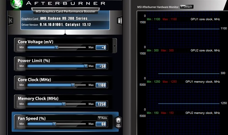

I am having some more black screen issues with my R9 290.
Basically I bought my 290 just before Xmas to replace my 7950, now when I first got it I had some major black screen issues when playing low intensity games, mainly DOTA2 (although anything which maxed the card never crashed).
Luckily the 14.1 beta drivers seemed to fix whatever was causing this issue and I have had trouble-free gaming from Jan-April. Now roll on a few days ago I have been having massive black screen problems, only in DOTA 2, mostly on the main menu, its the usual black screen hard lockup, although sometimes it will recover with the usual display driver stopped responding rubbish. If it does recover however, the memory will be locked at 150MHz and needs a re-boot to allow it to clock back to 1250MHz.
Now when I run MSI afterburner in the background whilst playing DOTA, the memory will sit at 1250MHz happily, but the GPU clock speed will fluctuate continuously between 400 and 600 MHz, when it should be locked at 975MHz in 3d mode. The GPU usage is also all over the place depending on how high the card is clocking itself.
I believe that this continuous change in GPU clock causes the display driver to stop responding, probably just because it gets confused eventually.
I have seen a similar problem in X-com, where having v-sync on didn't put enough load on the GPU to warrant the full 3d clocks, making it sit between 400 and 600MHz meaning it blackscreened every 10 minutes. I have a 144Hz monitor so I just turned V-sync off and the GPU usage went up to 100% at 975MHz and I managed to have a 3 hour session with no crashes.
It must be this changing core speed that causes the crash because I can run BF4 and tomb raider for hours, which will happily sit at 975MHz core speed 100%GPU usage and never black screen. (I have a custom afterburner profile for fan speed which keeps the temps below 82c)
I have tried every driver between 14.1 and 14.4 beta, none of which seem to fix this. Although I have no idea why it has suddenly gone bad again after 4 months of no-issues, although I suspect it's a random windows update or similar. Even turning the V-sync off in DOTA just dosn't generate enough GPU load to force the card to full clocks.
Now my question: Is there way like a BIOS flash or something that I can do which will force my 290 to sit at full clocks rather than this odd intermediate state between 2d and 3d mode? I'm 100% sure this is the cause of my crashes but I can't find a way to fix it in this particular case.

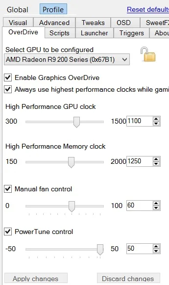

Is the game not very demanding? Please use the links in my sig to report the driver issue to AMD. Then try my fix below.
Try this for a fix for the clock dropping. No need to use unofficial overclocking method either so clocks will drop to 2d levels as normal.
1. Download RadeoPro - http://www.radeonpro.info/2013/11/new-build-with-support-for-amd-radeon-r-series/
2. Create a profile using the game exe.
3. Click the profile tab, then the overdrive tab. Click the padlock to unlock overdrive, click enable graphics overdrive, the click 'always use highest performance clocks while gaming'. Don't forget to set +50% power tune in RP. Apply clocks and voltage settings through afterburner first. Now right click the game profile shortcut on the left and select apply then launch the game.
Ah brilliant, thanks LtMatt, this seems like it's what I need. Would you suggest a particular driver version or should I stick with 14.4 for this?
Also DOTA2 is like the least demanding game ever, I think the minimum requirements are Radeon 2600, which is why the GPU usage is so low and the core speeds get confused.
Either way I'll give it a try when I get home and report back.

I didn't get chance to have a proper test last night but it certainly seems to have locked my clocks to the right speed and I was able to leave DOTA on the main menu for a good 15 minutes without a crash, which is probably long enough.
Will report back once I have had a proper try over the weekend.
well that seems to have fixed my issues*, managed to play dota 2 for a full 90 minutes last night with no crashes, even after a long stint on the menu waiting for the dam matchmaking.
