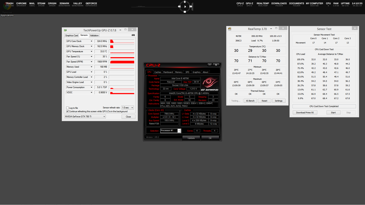

Hi all,
H80i user and as we are in warmer weather I have brought my OC down from 4.5GHz to 4.2GHz and paid particular attention to my core temperatures. I've seen a big shift in temperature differential between the cores when under any stress. The example below is after running Prime but during gaming it will hit the high 60s/low to mid 70s on core 0 whilst staying in 50s/60s on core 3.
My first impression was that it was just the CPU silicon lottery in effect and a poorly applied TIM by Intel but it looks like I was wrong as taking the back off and actually looking at the backplate, I see it's installed upside down. Would these temperature differentials correlate to the picture of the backplate below? Or would a good enough seal still have been made chip side when it was fitted, I ask this is it was OCUK who installed this cooler on my behalf.

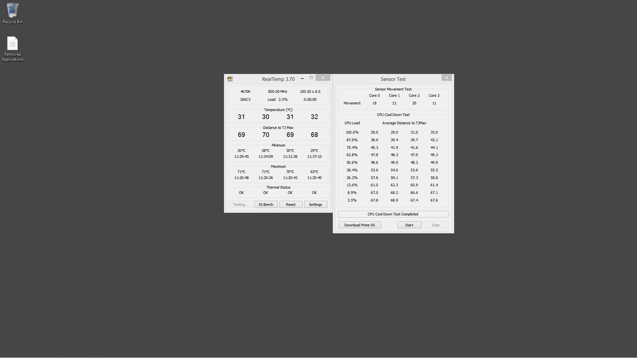

Done the trick!
Well that's that done.
Took of cooler and reinstalled the backplate the correct way and the max temp on core 0 under prime 95 is now 71 degrees as opposed to 86 degrees before. Also seeing closer temperatures across the 4 cores under load. This test has been done after a couple of hours of the PC running lots of updates and software installations as I decided to refresh Windows as well and it is both very warm and humid here. So very satisfying figures I think. This was on the 4.2 OC.

Edit - PC has been running for in for a good few hours now, new test run a little earlier with lower top end temps hit and nice idle temps recorded since too. :)
