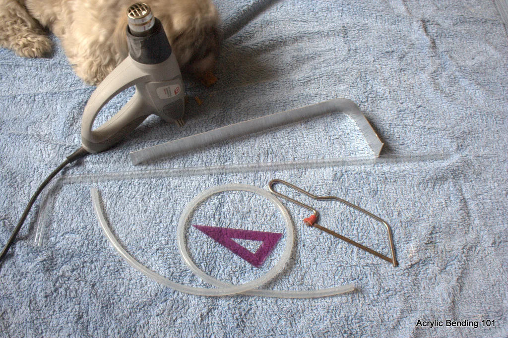

First up is the basic kit we need.....(Magoo optional)

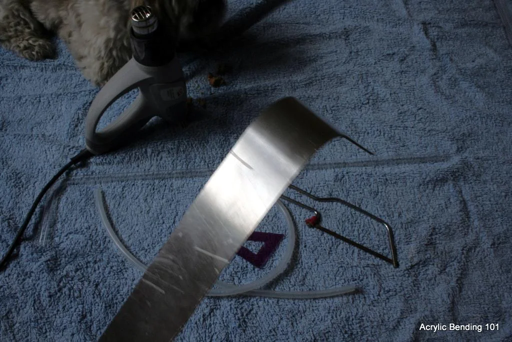

We have a heatgun,tube,silicone fuel line that has an OD matches the ID of the tube you wish to bend and a former....the square is for checking the 90 bends on the former.
So,the former,in this case a 2" wide piece of sheet alu rolled over a deodarant can to get a radius,you can select anything with a diameter of 40mm or over,thick walled tube will need a larger radius to prevent kinks.
The line is the bend start,this will become clear in a minute
The beauty of this is that you can form any specific angle you like and bend tube to it.
For instance: You have 2 ports you wish to join on the same plane,you can form the pathing from the inner measurement between the ports and bend a former to suit. Measure the closest points between the fittings from the actual tube insert point,bend the former so the 2 faces on the 90s match the gap and Bob is indeed your uncle

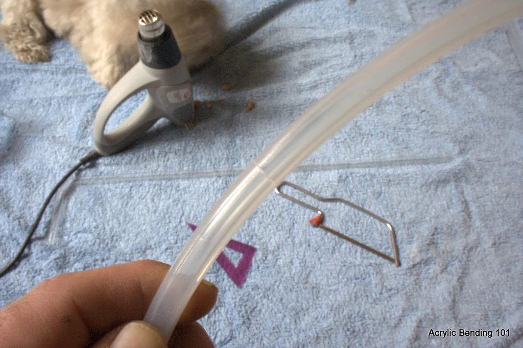

The silicone fuel line.
This needs to be around .5mm smaller that the ID of the tube you are bending
Normally used for RC cars,chosen for its high melt point and great flexibility.

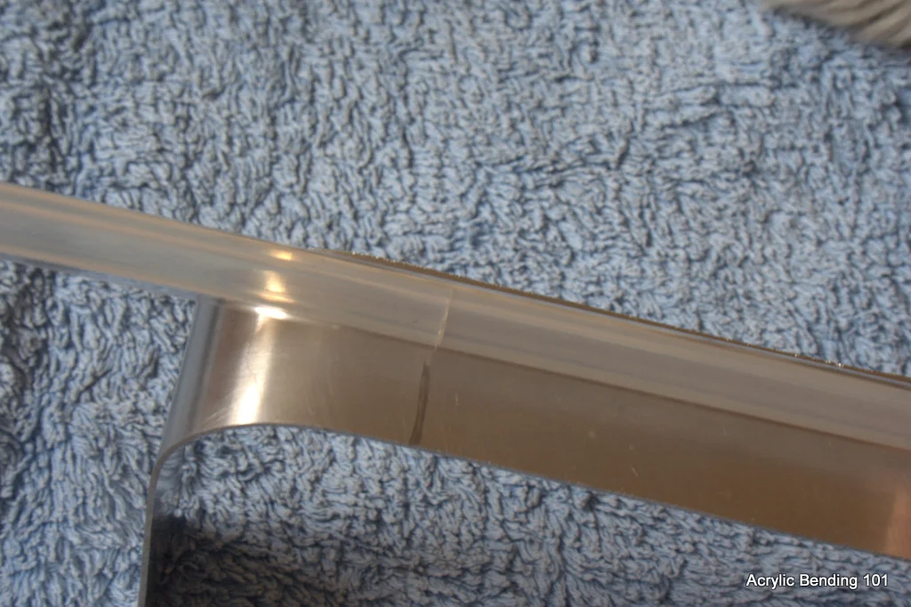

The small cut line round the tube is placed at the start of you bend and is the reference point for another way of doing point to point bending.
Remember the pencil line on the former? Well,put the cut line of the silicone tube on that ref point when doing the bend and you will get consistent bend radius measurement.

The bend.

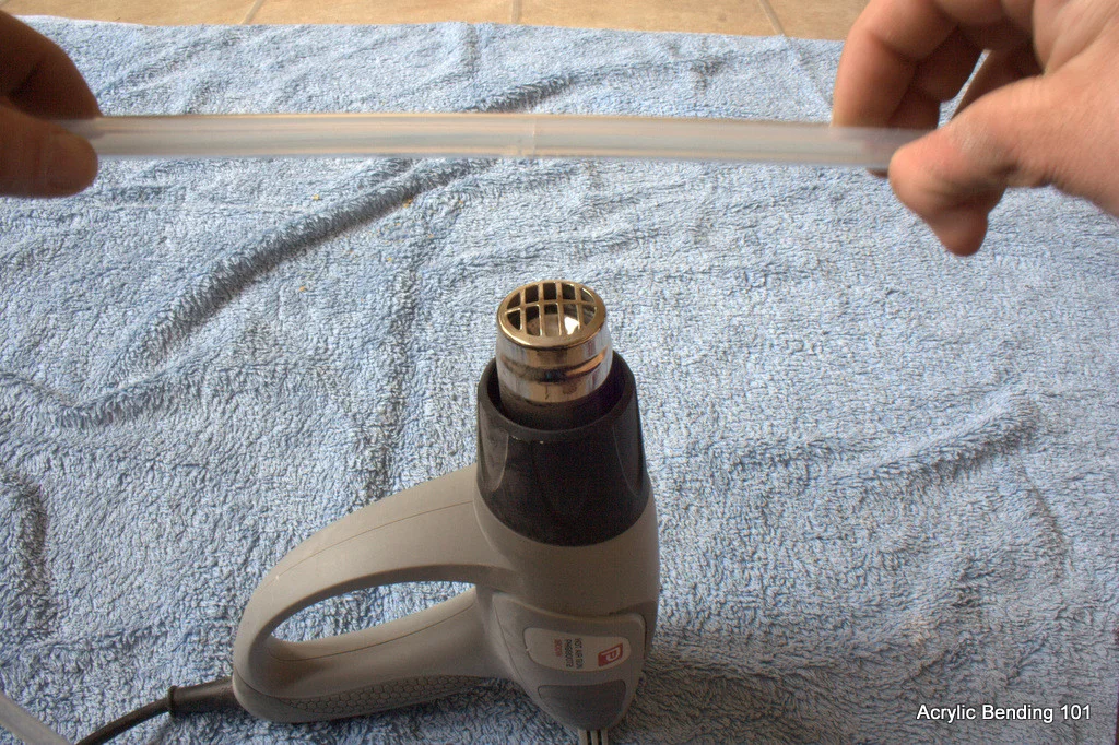

You cant see the fuel line mark but its ion line with the former ref point,this is the distance you will need to heat up ,around 100mm with the bend start 2/3 its length .
This creates a very even bend.
Hold the tube around 70mm above the heat gun on high.
IMPORTANT: Keep the tube moving,rotate constantly,do not let the heat sit in any one place.
Soon the tube will not be able to hold its own weight,this is the critical moment,too long and it will create visual anomalies and start to burn.

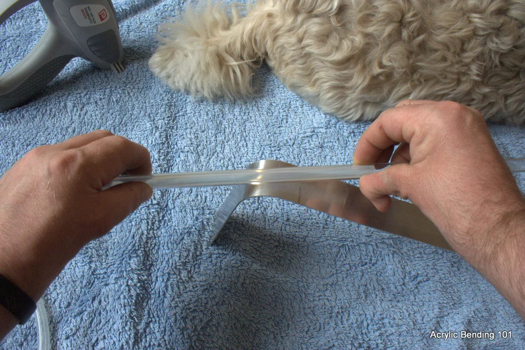

Now i dont have pics for the next bit as i only have one pair of hands ...

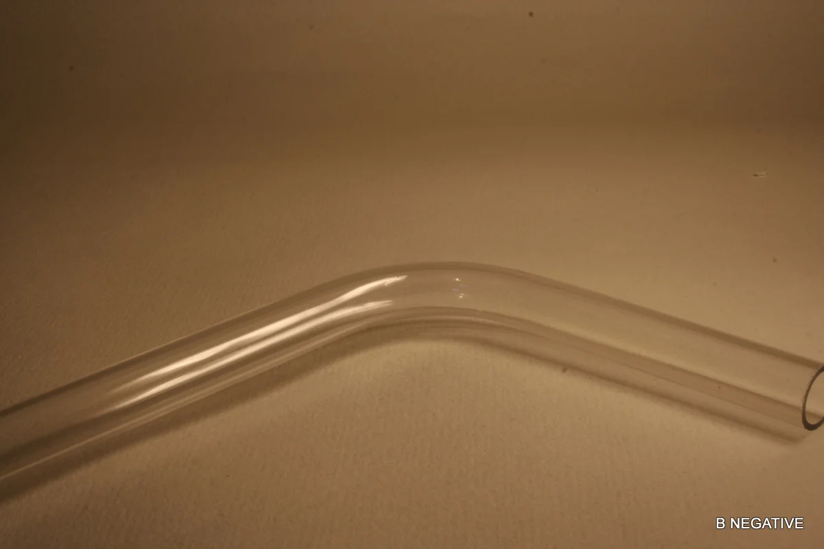

When the tube starts sag,quickly transfer to the former,matching the 2 ref points up and slowly 'form' round the radiused section,dont force it,take your time. If it starts to stiffen then re heat as required.

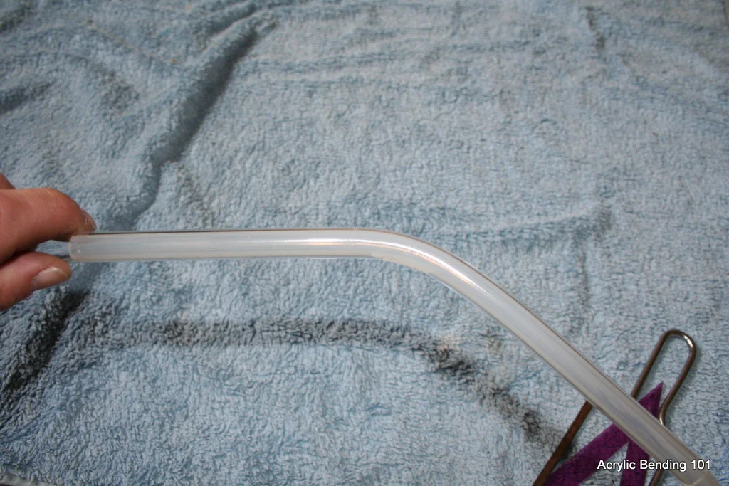

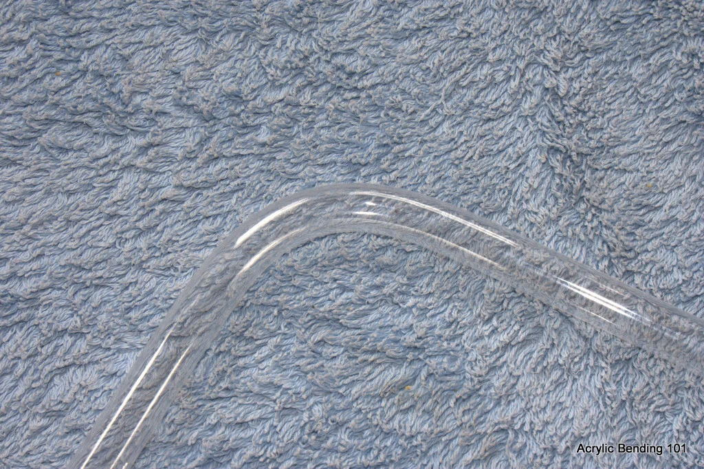

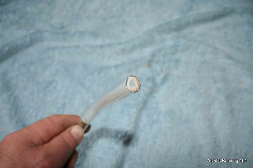

When you are happy with your bend then let it cool naturally,when cool you can twist the fuel line straight out with no fuss.

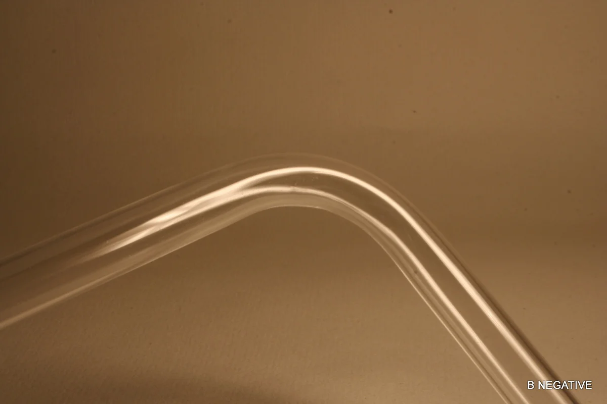

You should be left with this

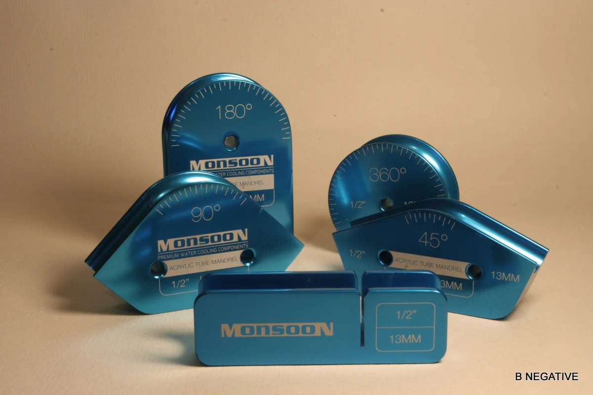

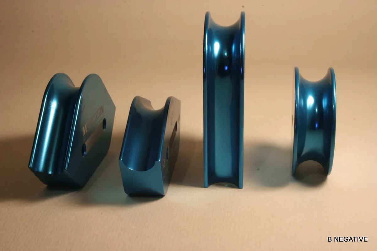

Monsoon have come to the game with a new mandrel set with everything you need with the basic technique shown above but with purpose built mandrels/formers and a new range of fittings with a novel locking technique.
The Monsoon hardline kit videos:
http://geno.boxgods.com/Hardline_Premium_Fittings.mp4
http://geno.boxgods.com/Hardline_Tools_Heatgun_Kit.mp4
http://geno.boxgods.com/Hardline_Tools_mandrels_and_Measure.mp4
http://geno.boxgods.com/Hardline_Tools_mandrels_and_Measure_2.mp4
http://geno.boxgods.com/Hardline_Cutting_Kit.mp4
Monsoon Kit.
The bend quality is excellent! A slight pulling motion round the mandrel makes the bend flow very well.

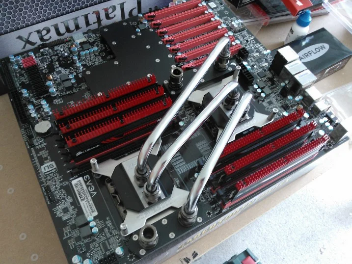

I have been asked a few times now how i bent my pipe for my SR 2 build,so i decided to do a little walk thru.

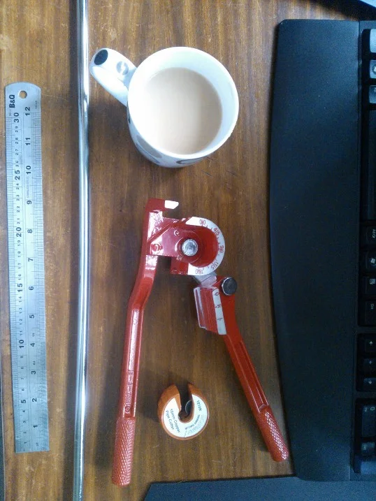

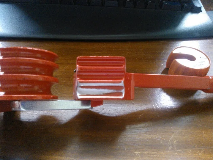

The tools you will need are these:
A Cup of Tea...mine was a milky number to get the juices flowing.
A set of benders...these are for half-hard pipe,not annealed pipe as annealed is thin walled and should be bent by hand.
A Cutter for the chosen OD of your tube
A Ruler
Some tape.
I recommend Rothenberger benders,these are high quality and are worth the extra.
Otherwise,you may have to 'mod' the benders..like this:

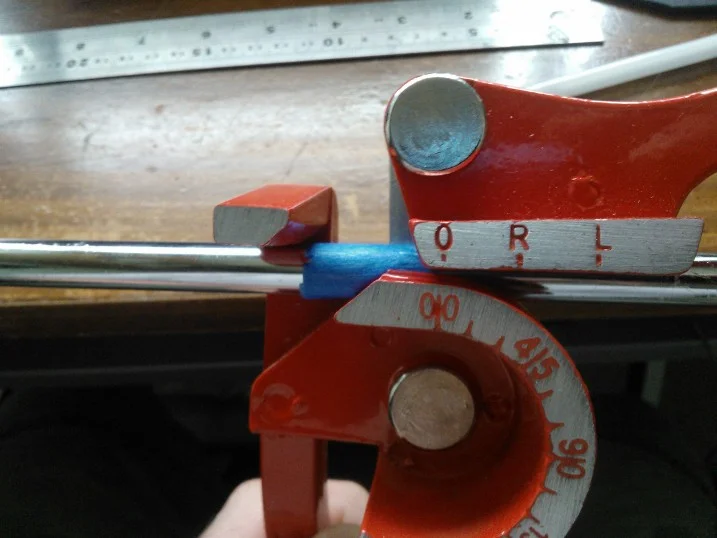

The top guide was poorly aligned and needed a bit of work before use.
Poorly aligned guides can distort the tube and put creases down the length of the bend.

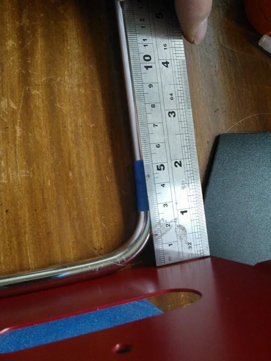

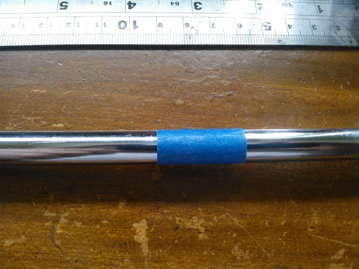

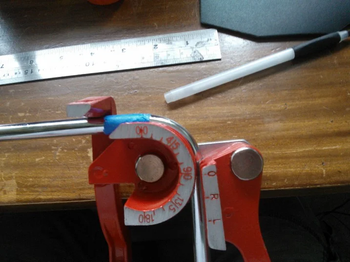

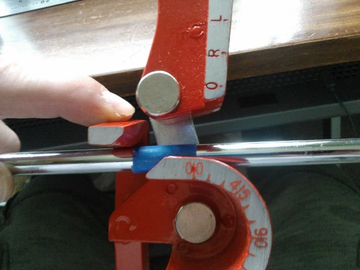

So..take a bit of tape to make a base mark.
Place the base mark on the 0 point of the bender.
Line up the guide with the 0 mark.
Make the bend using constant pressure,dont snatch at it,use nice firm and even pressure.
Once you have made your bend,measure the distance from the 0 mark and the outer wall of the bend.
This is the radius measurement,in this case 28mm,remember this as it will allow you to make accurate 90-90 bends to go 180 like this.

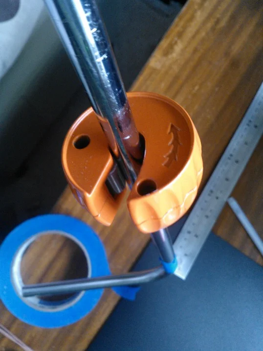

To cut the tube to length,use the cutter,rotating the the direction indicated on the tool.
Try to keep everything straight when cutting,the cutter can spiral if its not held 90 to the pipe.
I prefer Autocuts as the pressure is wound on gradually with less flattening of the tube.
