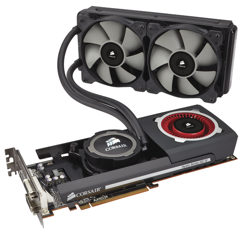

Corsair HG10

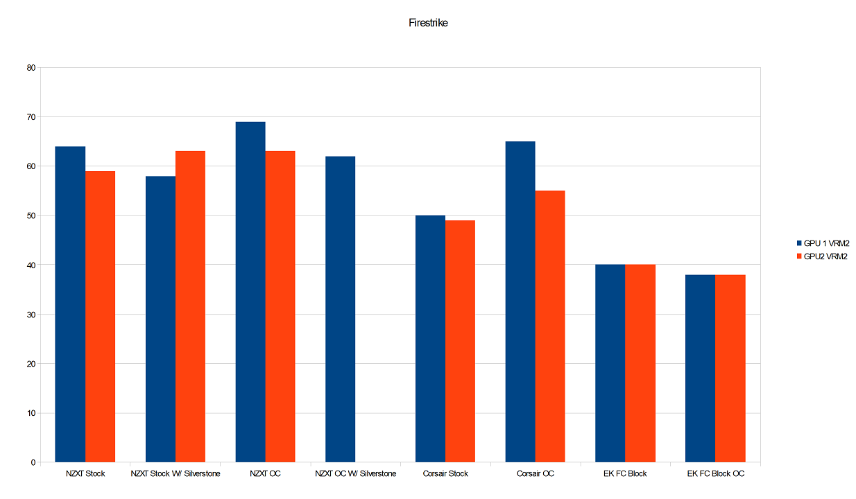

VRM Temps are where the biggest differences are.
If we look at the overclock Speeds VRM1 on GPU1 has been the biggest problem for me
NZXT 82C
NZXT w/ Silverstone 92mm 71C
Corsair 70C
EK 48C
The corsair has a very nice improvement over the NZXT but the EK Full cover block knocks everything out of the water. The stock 92mm fan on the NZXT is very bad and a cheap (£6.95) fan from OCUK (https://goo.gl/2jDLqT) made a huge improvement, but the corsair still beat it and works out cheaper.
VRM2 was not as bad to cool
NZXT 69C
NZXT w/ Silverstone 92mm 62C
Corsair 65C
EK 38C
Again the corsair still worked better than the NZXT but the EK wiped the floor with everything (Remembering that the EK has less air intake as well).

The NZXT once you add VRM heatsinks & upgrades the fan to something like a silverstone 92mm it performs near the corsair but the looks of the corsair are loads better.

The full custom loops set me back about 449.99 so when you add it up the corsair block is the best value but if your after high overclocks then nothing will beat a full custom loop. Just a note on the corsairs though you do need the reference R9 290X blower fan. I believe corsair will be stocking theses shortly though.

Now I don't like full cover blocks due to the expense and the fact they only fit a single card but that clearly shows just how much better a custom loop is if you can afford it. Damn, that Corsair HG10 is bloody ugly!!

I think the corsair thing looks 100x better than the nzxt one. And if the water block isn't a full cover I would have to go with the corsair over that aswell.
