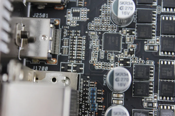

However what if you want to buy a card which fits your budget but you know for sure it has a I2C addressable controller? I know first hand how tricky it is to find a clear picture of a VRM controller, not only that I believe that Asus is rebranding its VRM controllers as Digi+ which makes identification impossible for an individual without owning the card and testing it out.
Here is a picture of a VRM controller (as you can see its sitting next to a long line of VRMs and is square with 10+ pins on each side):
This one is cheap and nasty with no I2C addressing.

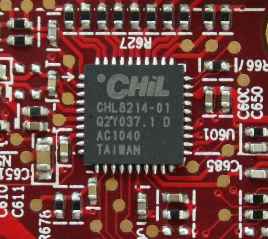

Here is another picture of a different VRM controller:
Since its on the list below its supported by MSI afterburner. If a card carries one of these it is either already in the hardware database or it can be added to the hardware database (by probing the I2C bus).
