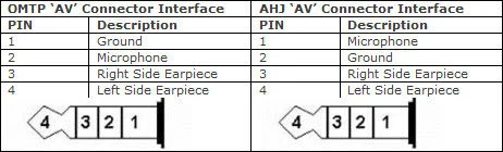

Recently got my iPhone 6 headphone socket replaced by a repair shop (non Apple) as original one got the tip of a headphone jack stuck in it.
Ever since, it seems that the iPhone no longer likes Apple headphones. However, works fine with none Apple stuff (convential 3.5mm headphones). I have a pair of E10S SoundMagics which have a handy switch on them for using them with either iPhones or Sony/older Samsung phones. Ever since the repair, I have to set the switch to "B" or non-Apple mode for them to work properly. If on the A (Apple) setting I get very weird audio. Almost like a load of channels are cut out but not quite an entire side.
Just need to work out what is needed for this to be fixed. Perhaps the shop put in a part that is wired in the non Apple way?

I read somewhere the "ground" and "mic" sections are the reverse of the standard design. Will take it back tonight and see if they can re do it. If not, guess I can live with it! Bit weird owning an iPhone that can't use the official headphones though! But not massive problem. I just sometimes like them purely for the hands free mic. The E10S has one as well but it won't work with the iPhone in either switch setting now!
nope it shouldn't do that I think the part he fitted is faulty. Ive repaired many charging docks and that is part of the headphone socket which wont be affected when changed. Also you can get official apple parts on ebay they are used parts removed from icloud locked or water damaged phones.
Correct, it sounds like he wired it wrong:
Left is Apple, right is other phones.
