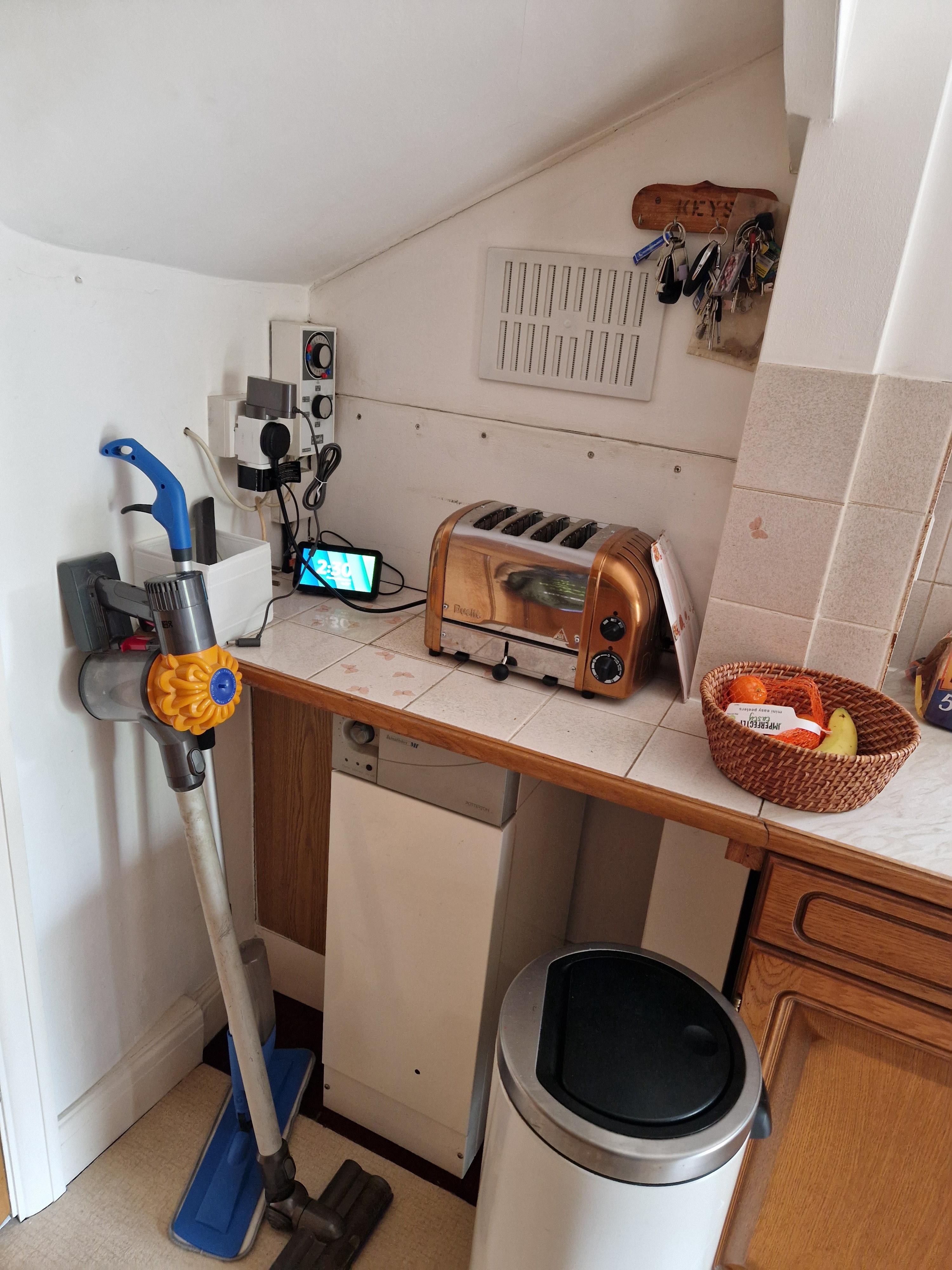

  • Image 1 - Leave the boiler where it is. It is pretty much dead space anyway (under the stairs, door opens in front of it)

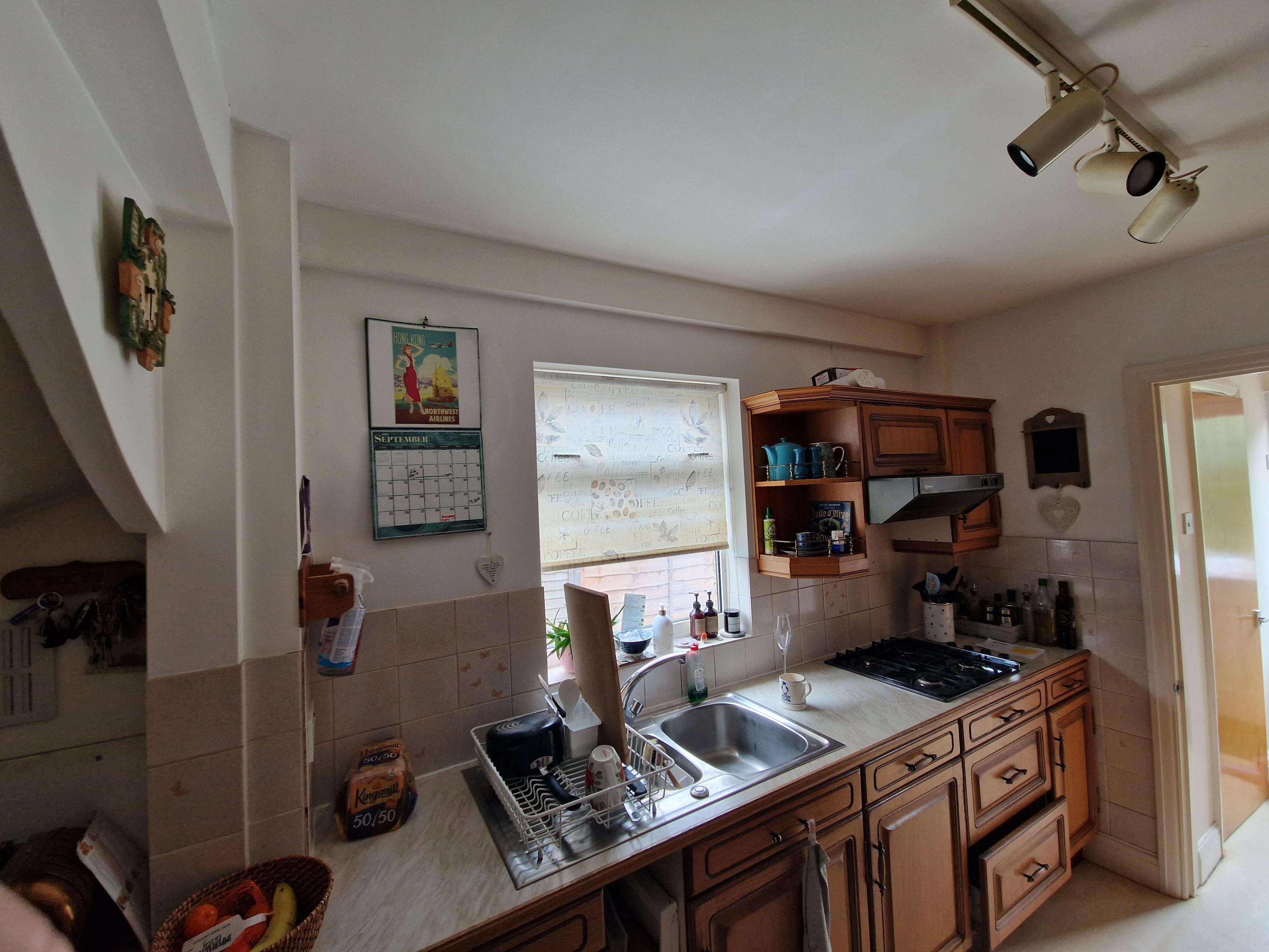

  • Image 2 - Re-new the cold feed via the back of the units as opposed to "up and over" the kitchen window

1. Is this silly? Should I be considering moving the boiler to a different room, given all of the pipework runs to the opposite side of the house? Is there a clever framework to work out the best place to put these things?
2. If keeping the same location, is it permissible? The flu is super low (hip height) at the moment
3. What random pipework am I likely to uncover in all of these boxing in sections (in the kitchen specifically?). Gas comes in via the left hand side as the meter is only about a meter away.
4. Can I easily spur off of the hot water tank if it was in the loft (to enable my new bathroom?)
5. Do I need to consider the placement of pipes in the attic if I am going to do a loft conversion (unlikely in the next 5 years) - i.e. should I run them through the joists or would a loft conversion mean new joists anyway?
6. Is getting a weekend to run a new 'ring main' (whatever the plumbing equivalent is) to do the downstairs rads (only 8 rads total I think) time worth spent BEFORE getting the boiler/tank replaced?
Image 1
Image 2
Image 3
Question:
1. put the boiler in a convenient place, run a core of 22mm pipe to the center of the house upstairs and down, then offshoots of 15mm to 3 radiators, they also require everything be lagged behind walls and floors.
2. yes the boiler can be kept in the same place, just cage the flue
3. I guess you'd maybe find 28mm copper primary pipes, a 15mm cold main and a 22mm hot water pipe
4. you can spur off a hot water pipe as much as you'd like unlike a electric plug.
5. first fix the pipes and label them in the loft and the joiner can work around them with their new joists, the small joists in a loft are mainly there to hold up the ceiling, not lots of humans, a bed and wardrobes
6. I guess it makes sense doing as much as possible before you switch over to the new system so the hot water and heating isnt off for too long, if its an empty house then it wouldn't really matter.

Cheers Mickie. This is actually just what I needed.
I think the boiler is probably OK where it is then, with a bit of a "lift and shift to the left" to use the wasted space a bit better.
So I think what I'll try and do is run 2x 22mm from the loft to the first floor, and then 2x 22mm from the loft to the ground floor. I can probably first fix the rads with exposed pipework and sink it under the floor later on.
I'll also probably want to renew the feeds from the boiler to the tank, and from the water main to the tank. Is that another 2x22mm?
Would you recommend swapping the tank out for something special? The chap mentioned a megaflo as the latest and greatest..?
No worries, yeah run a 22mm cold mains upto the tank and 2x22mm primary pipes from the boiler to the tank, you'd be better off following a schematic.. megaflo should be fine, they come with massive guarantees.. Have you seen the mixergy cylinder, they're pretty cool smart cylinders.
No worries, yeah run a 22mm cold mains upto the tank and 2x22mm primary pipes from the boiler to the tank, you'd be better off following a schematic.. megaflo should be find, they come with massive guarantees.. Have you seen the mixergy cylinder, they're pretty cool smart cylinders.
