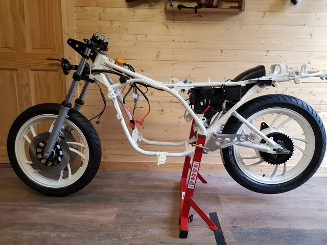

The job has fallen to me to rebuild it from the ground up as a tribute to my late dad and his love of bikes.
This is how the bike currently sits.

I have started the strip down to see what I have to work with. After all these years I'm going to rebuild the engine and repaint/chrome and replace anything that's needed.

Swinging arm came apart easily enough? The main pin/shaft used to seize on those. I restored an RD250LC and had to buy a modified (non Yamaha) swinging arm shaft that had grease guides through it, why they never did that in the first place. I'm going back to 1990 when I did this mind!
The shaft had a grease nipple at one end and was greased to the max so It just slid out.
Everything had come off pritty easily so far. Going to have a pop at the engine this week and get a new gasket kit ordered for it on payday.

As you can see the studs are horrible rusty shadows of themselves so I am trying to remove and replace them. ( 2 out of 8 so far removed)
My stator removal tool comes today so can get on with that and more this weekend.
Both wheels have been stripped and bearings removed for blasting recut/refurb.
