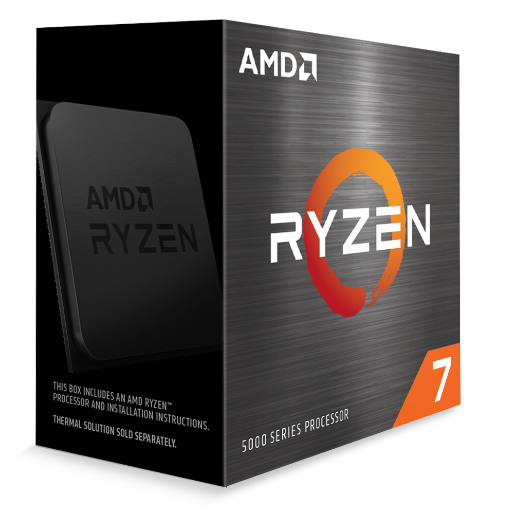

8 core cpu rather than 6 core, the 7700 also comes with a very respectable stock cooler (wraith prism)

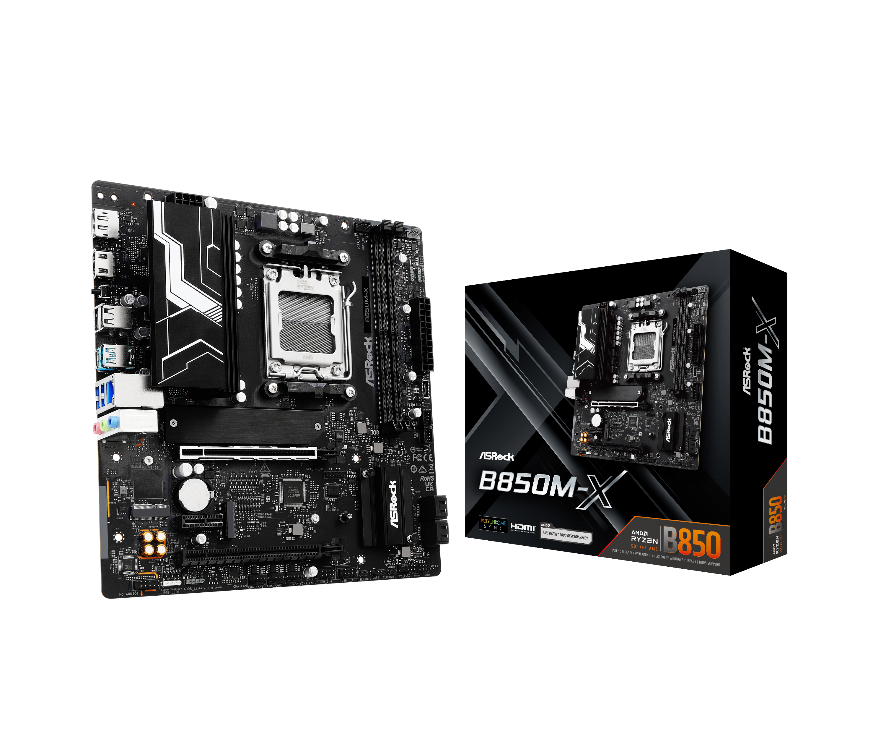

better motherboard

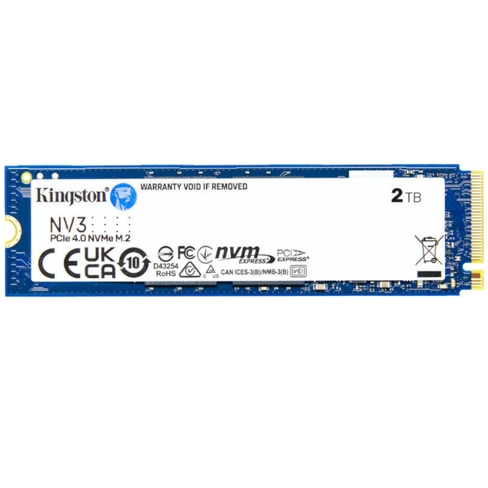

better ssd (TLC nand - the nv3 uses QLC nand with lower endurance)

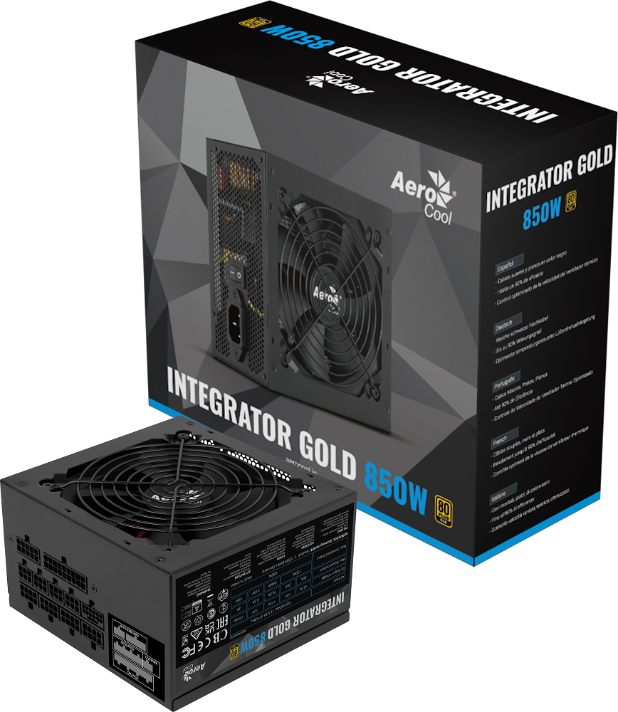

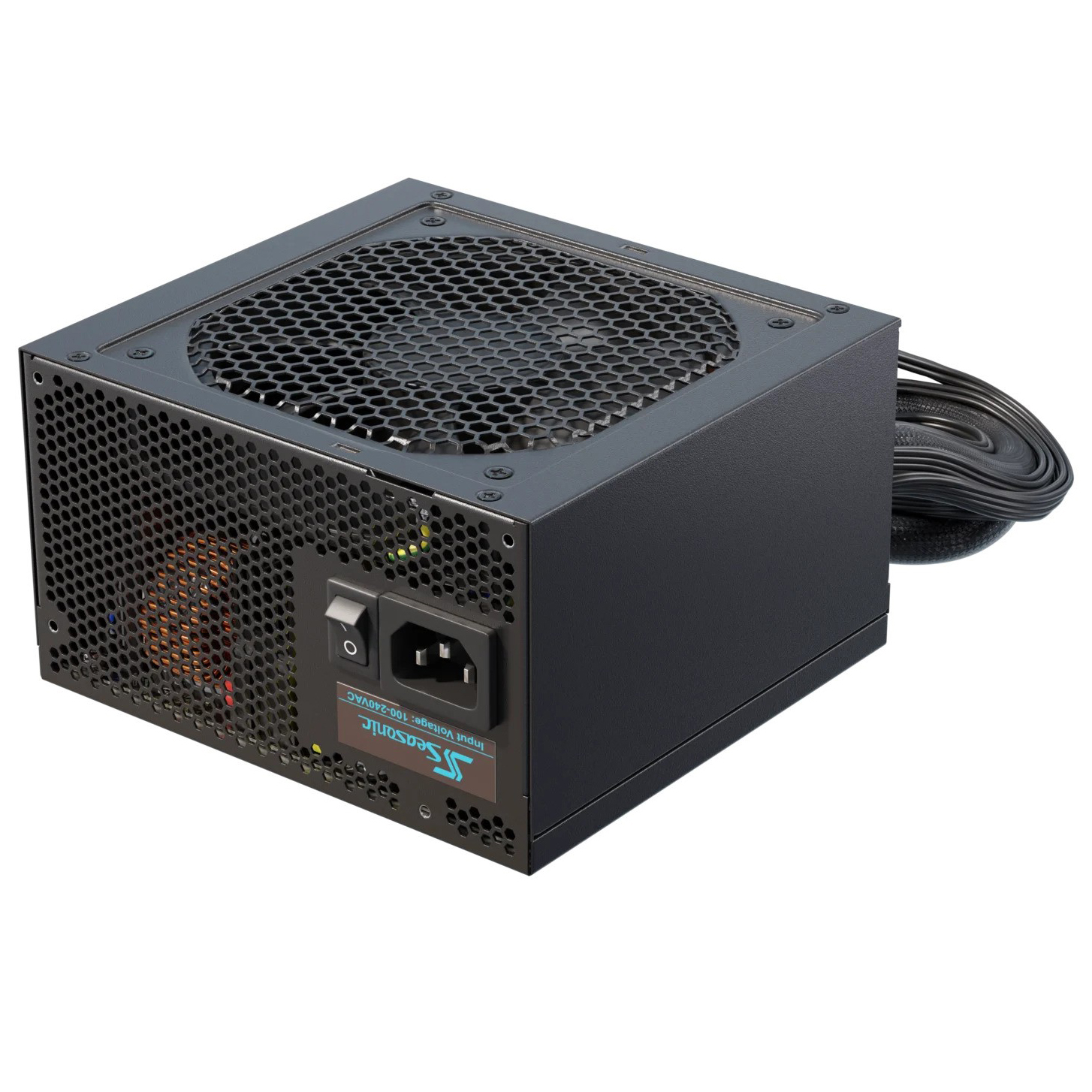

higher quality psu with longer warranty 10 yrs vs 3 year

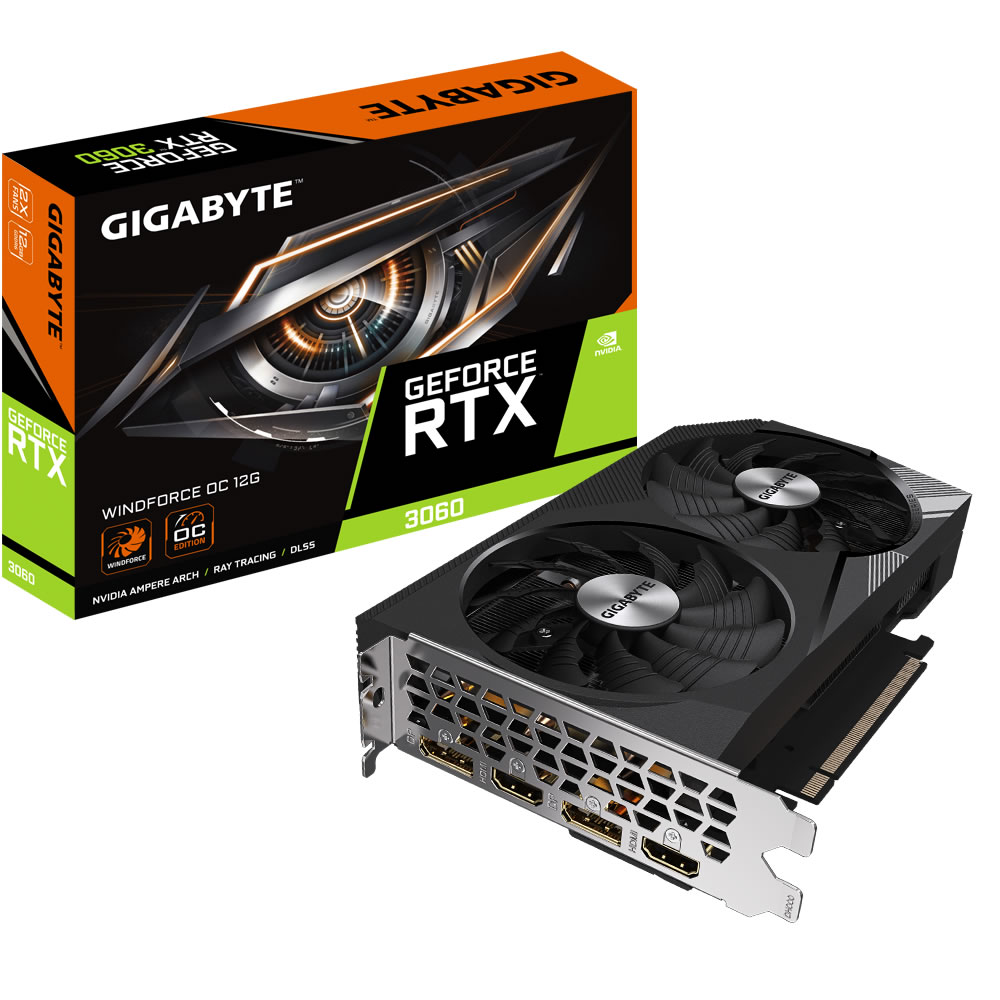

GPU is a bit unclear - on paper the intel b580 is 25-30% faster for gaming workloads compared to the 3060, though you may want to keep to the 3060 if you use nvidia specific features for your work, eg CUDA. also intel drivers aren't as polished (not that nvidia are doing particularly well on the driver front recently lol). other than the B580, there isn't any cheap GPUs with 12GB or more RAM

better motherboard

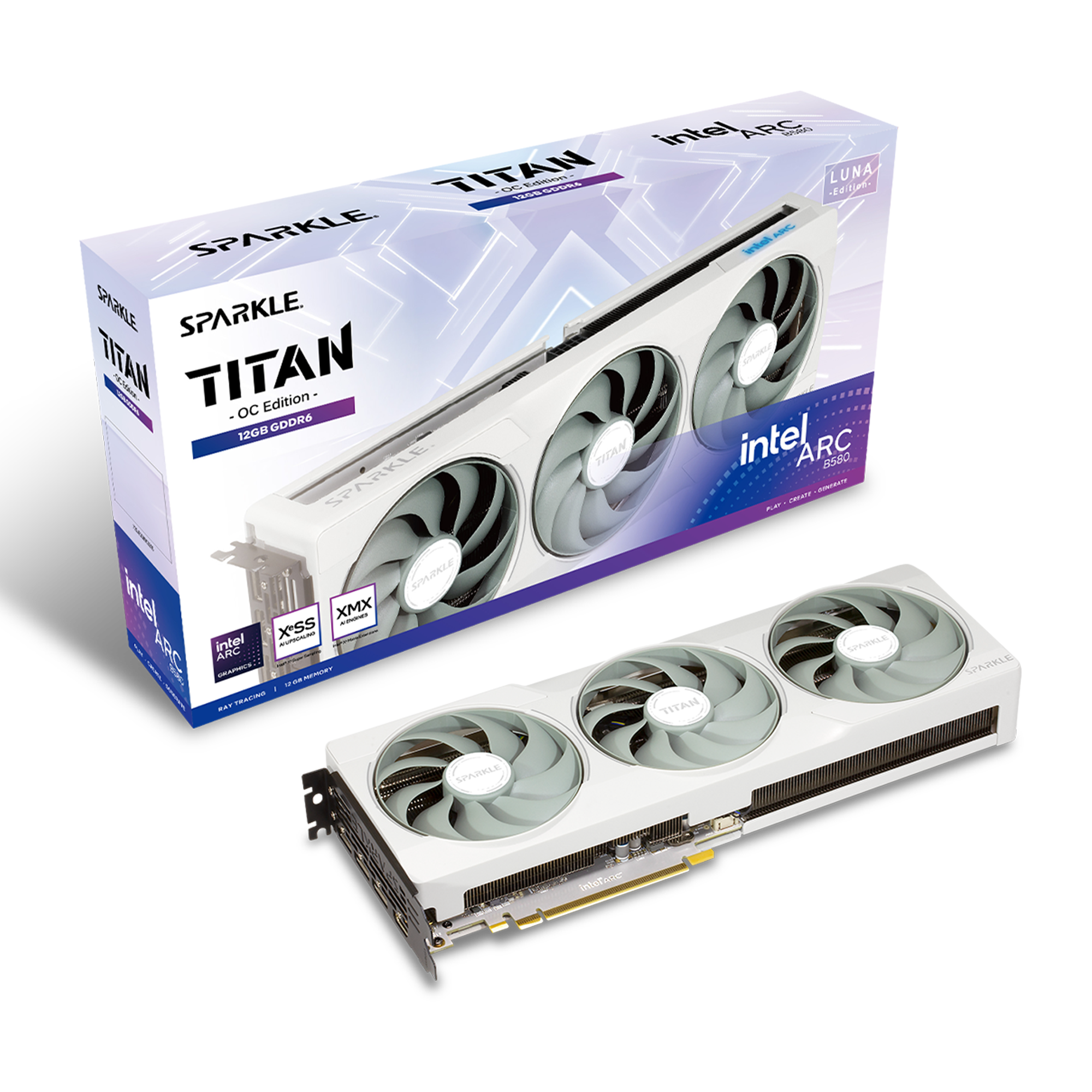

In the £250-ish category, intel b580 probably best value currently. Rest of the lineup gimped with 8gb vram.
Unsure where the new Radeon 9060 will land, may want to keep an eye on that depending on how quick you need to upgrade.

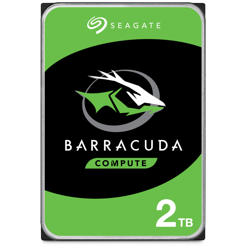

you only need 32 of of ram, do you really need the extra 2tb hdd, you could save £140 there that really need to be pumped in to GPU.

Went with the Intel GPU suggestion as that seems to be best value at the price point, gaming is almost a secondary requirement here (PS5/Series X/Switch mostly dominate that area for me) and I'm fine on lower qualities when I need to. I can always upgrade this down the line if/when it starts lagging behind too much

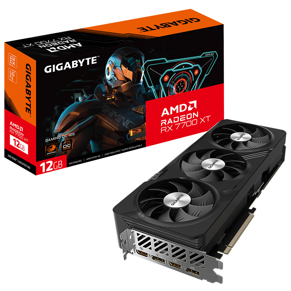

Ok, so within the £1200 budget to squeeze in the 7700XT, which is 20% on top of the B580 performance (and don't have to deal with intel drivers)
the compromises:
ddr5600 rather than 6000 for the 64gb ram, you do lose some performance, but given the hefty amount of ram, there's no guarantee that the cpu will support 64gb of 6000 ram in the first place
cheaper psu

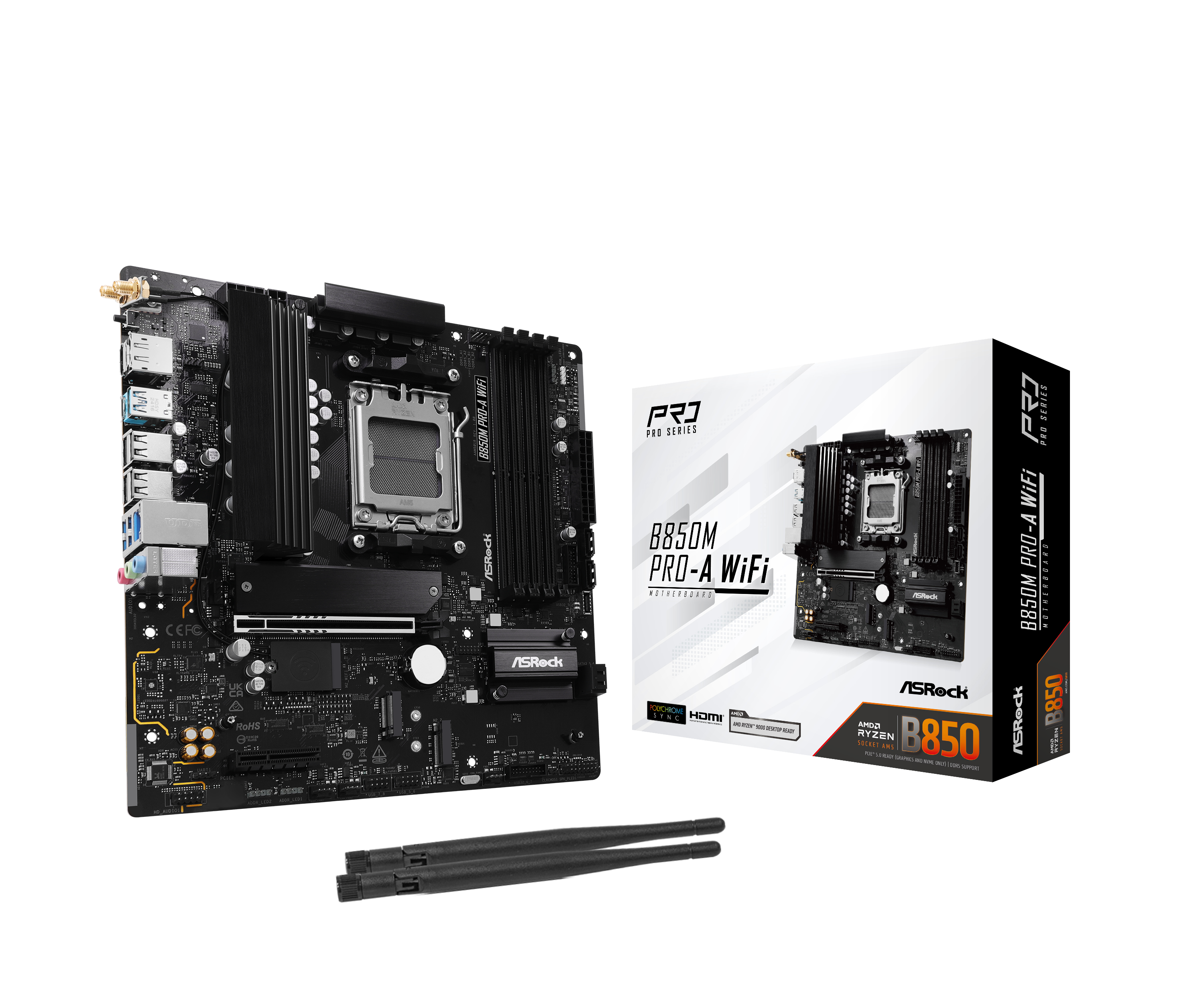

cheaper mobo (lose the pcie 5 to the gpu and also wifi - the same board with wifi is £10 dearer but OOS at the moment)
is cramming in the 7700xt worth the tradeoffs? personally, yes.
(though if you have the £30 extra then i would get the £145 asrock pro-a as previously specced - better vrms, pcie 5 to the gpu slot and wifi)
