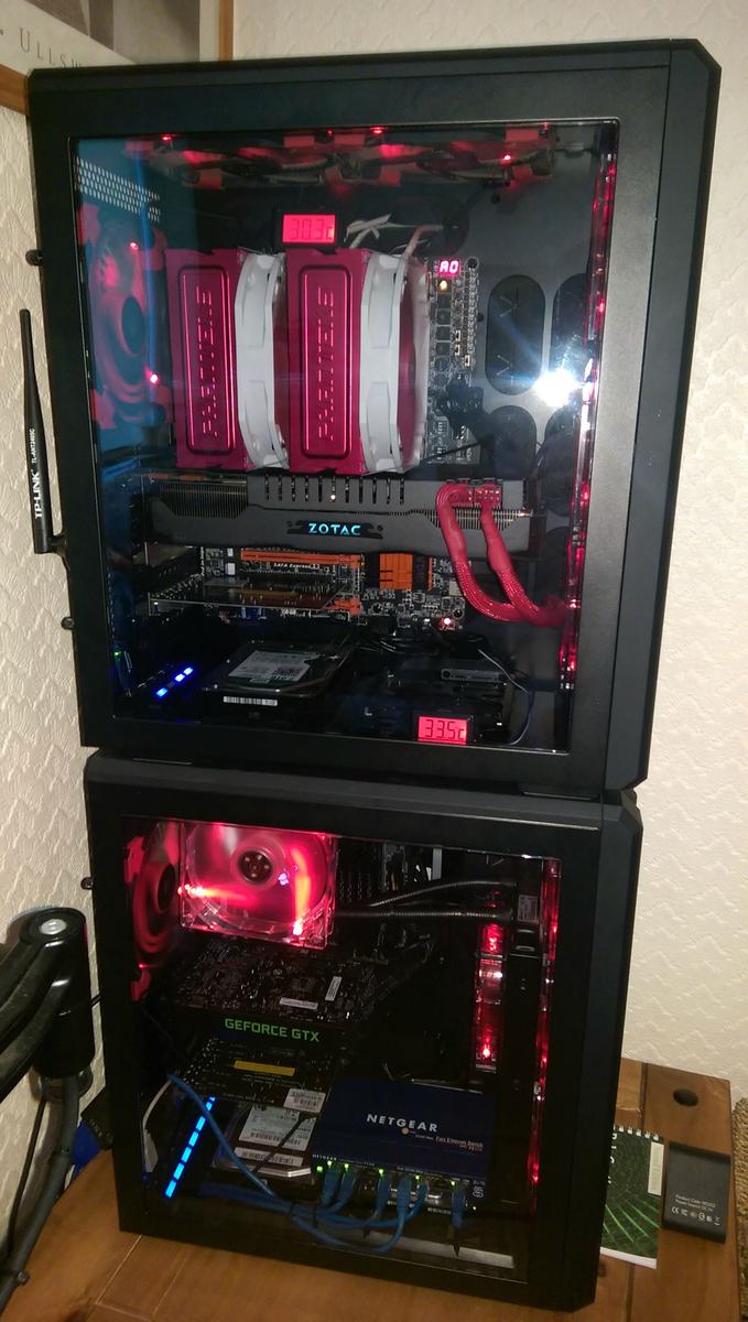

Ok, installed and running, the temps are around 5c higher than with the kraken aio but as you'll see in the pics, the heatsink is like 2mm off the gpu backplate and the gpu is running at 100% 24/7
Before:
After:
In the case, you see how close to the gpu it is:
And a close up to show the height and clearance in the Air 540 case:
It is nice and quiet though, even with the fans at 100%. I think I'll move the gpu to a lower pcie slot, there's 2 pciex16 iirc, i'm sure the temps will be significantly lower then.
The bottom PC is next and there's much more space between the cpu socket and the pciex16 slot on that one.

Moved the gpu, cpu temps are now pretty much the same as they were with the 280mm aio.
gpu is now in a x8 slot rather than x16 but from what i've read there won't be any noticeable difference when gaming.
Just noticed my vrm temps have dropped by 14c now there's a load more airflow over them.

I have a probe in the vrm heatsink that usually displays around 45 to 49c and since installing the air cooler it is displaying 30 to 31c so definite and vast improvement.
Those fans are intake rather than exhaust but i'll give it a try.
Give or take a mm the underneath of the heatsink is 56mm from the motherboard, the fans are larger than the heatsink but you can move them up and down as much as you like really.

As I have the 2 cases stacked i have the top case intakes on the front and top with exhaust at the back and bottom directly into the top of the lower case. The lower case draws air in from the bottom of the top case and exhausts at the back and has intake fans at the front. It works really well but the dust now has a way in at the top so I must think of a way around it.
Interesting way of putting two chassis working together
Before:
After:
Damn that's close I just got my R1 Ultimate installed I had put a 3rd fan on it and it's like 2mm from my exhaust fan aswell! Things are massive.
