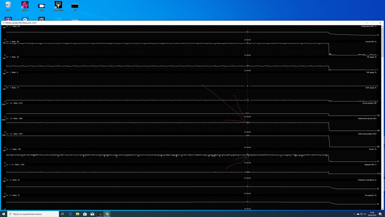

Few days ago ,when i run Fire Strike GPU test 1 on loop, i saw a clock dip from 1980mhz to 1570mhz for 1ms. GPU LOAD not changed,it was 96%. Only gpu clock dip for a 1ms.
I checked in logs,and during that gpu power drop to 58%.
Log from MSI:
But then i look at gpuz and gpuz not report that,all was fine,no drop in clock and power.

Its Fire Strike acting up, it happens every now and then with the new updates for the benchmark. It is also a 6year old test that has a few oddities on newer hardware. I would use Time Spy or Port Royale instead.

So anyway that dip in clock was not caused by hardware? Even if i cant reproduce..?!
Firestrike standard is dreadful for checking anything because the fps are too high and bounce off of the CPU.
If you are going to use Firestrike at all use the Ultra version or better still as the other guys have said use something more modern.
What is even more comical is the game Civ 5 which is 9 years old is a far better test of stability than any synthetic benchmark as it really works the CPU and GPU over a long period of time and can generate a lot of heat in the process.
