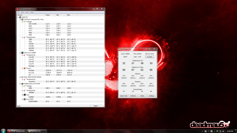

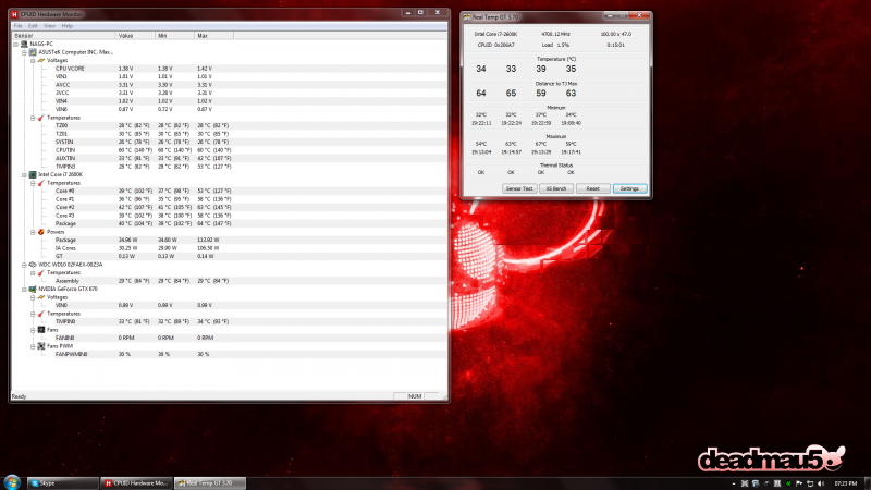

So after some tests here are the results.
I used prime 95 for 10 mins load 5 mins cool down.
3.4 ghz stock
4.7 ghz
i recently cleaned the block and cpu using thermal cleaner and then re-applied TIM using a small blob in the middle and made sure screws are locked down.
I might re-do and try and use a bit less.
The fact theres a 10c difference between core 0 and 3 is quite odd, i expect some difference but not that much
Anyone have any ideas ?
Looks like you have a dead spot somewhere on the CPU or block. Might even be not enough TIM on the heat spreader. Do a couple of test applications to see what coverage you are getting. What TIM are you using?
I was getting difference between cores on my old rig and when I took heat sink off the TIM only covered half of the heat spreader.
Make sure your loop is bled properly too and no air bubbles in CPU block.
