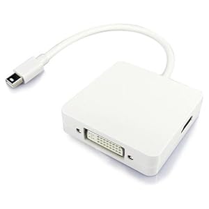

i bought 2 of these unfortnately (1 for spare), they was only £5 each but they could be useful for my laptop!
Mini DP to DVI/HDMI/DP all in one
shall get the ones you posted
Does it work? Better check that's actually an active adaptor. Pricing suggests it's a passive one.
Usually active adaptors are in the £15-20 price range.
