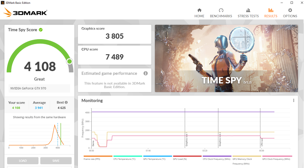

I've managed to grab a 3070Ti to upgrade an old GTX970 :eek: !

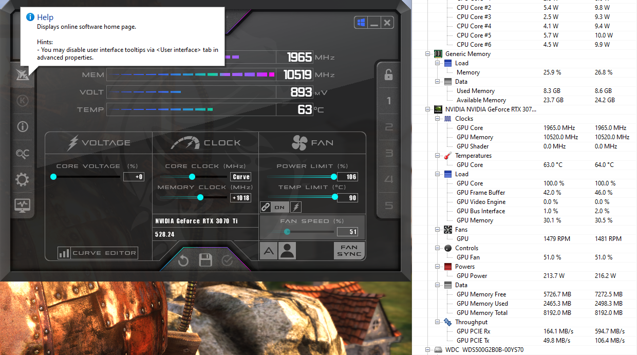

I can see a 30% lower limit on the software and this looks normal for a 3070Ti but I have it set to max 45% this seems the best for noise/performance. But after hours of gameplay it occasionally hits 81-83c then it fully ramps the fans to 100% cools down then 100% this only stops if I limit the power % it's almost like it's hard coded temp limit on the GPU once it hits that there goes the fan curve ha! Strange.

Have you tried monitoring the GPU temperature in Afterburner Monitor Display to see the correlation between actual temperature and the fan speed to check to see it is actually following the curve? It could be there is an issue with Afterburner reading the GPU temperature.
I don't understand why you have set it to max 45%. You should set it to ramp up to 100% at say 80 degrees. And yes, it's probably a safety feature in the card that is taking over.

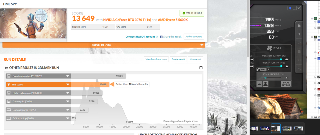

After playing with fan speeds I gave up, couldn't get it to play ball. Cant seems to control the GPU at a respectable noise level not to hit the 83c hard limit. Decided to watch a few tutorials in under volting, gone to around 880mv with a +900 on the memory. Max temp now is 73c with the fan at 1300RPM. It's now sorted! Just leaving Heaven playing a few more cycles to double check the max temp. Go figure, it's quicker and quieter! :cry:
Well after nearly 24Hrs of playing around, case fan speeds under-volting the GPU I think I'm happy now.
Temps do not go above 65c !
Nice upgrade from a 7 year old GTX 970 oh and a 5600X to replace an old 3600 :D
