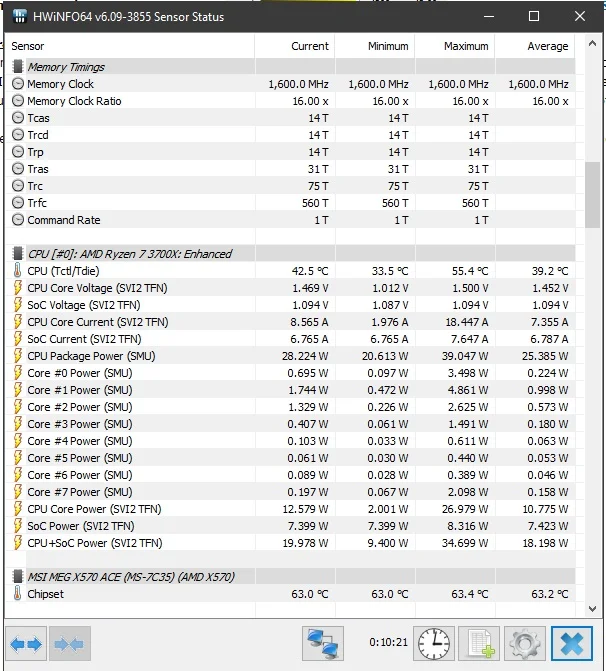

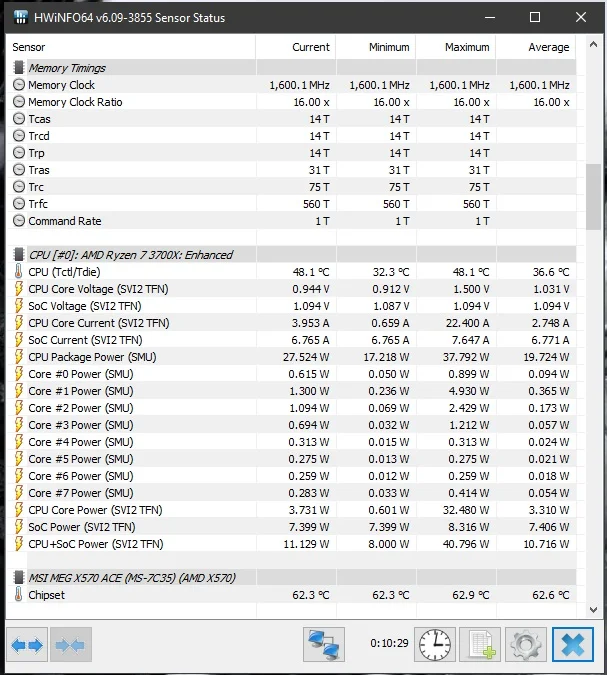

Ok so here's what I get from HWInfo
Windows balanced
Ryzen balanced
I had ryzen master running to double check voltages and interestingly the lowest it dipped to was 1.43 and stayed at 1.47, so the 1.012 reading is a surprise.
There's definitely a temperature difference at idle, but the average difference isn't as great as I expected.
If you were to no switch to high performance mode you would see that you CPU Package Power will be like 10W extra. Which is such a small difference people are worrying over.
