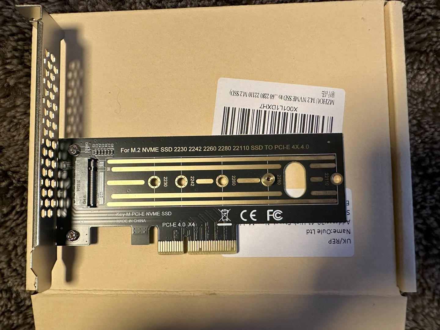

But do you know if i will get any problems fitting a Samsung 990 Nmve to this PCI-E card and using it in the bottom 4x slot on an Asus Z790 Dark Hero motherboard ?
The reason why is that my 990 is the one with a fitted heatsink so i can't fit it striaght onto the motherboard without risking breaking it by removing the heatsink

I can't see any lane sharing for this slot in the manual, so you're probably good.
The heatsink for M.2_1 might be removeable separate from the other heatsinks on the motherboard, but I can't tell for sure.

Should be fine - those adapters often have a heatsink, so they should be fine with the extra weight.
