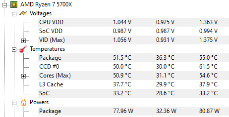

But I'm never really sure which one of the many cpu related temp readings (from monitors in Windows) the bios is reading from?
In the bios I only see the one reading for cpu temp but in Windows, apps like HWMonitor, show me multiple.
In the picture below for example, which reading is the bios taking for the curve?
And why is my min. value being reported as '0 RPM?' I read that as the fans are off? But I don't see how they can be with my current settings... any temp up to 40 degrees will always result in the cpu fans running at 40% right?

it all depends on what sensor is been read... but 5700/5800 and the X3d's idle a little high 40c is fine
just a reading error. it happens.
