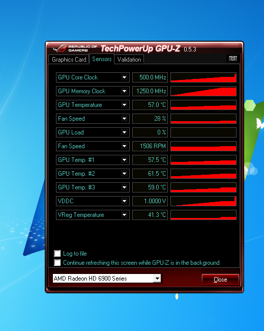

heres my idle temps if its any help
Im wondering if the Gelid icy vision Rev2 wasnt enough cooling for the VRM and its now damaged the card?...even though the gelid was only on for about 10 mins.
either way my card no longer like stress! :/
A few mins afetr that shot above,i watched a youtube vid..
Did you put all of the heat transfer pads back in place properly? That's 8 for the ram, a long sliver for the vrm and that little one for the shiny chip to the left of the top left ram spot?
The increase seems a tad high for 500/1250 speeds but not abnormally high as the GPU is working a lot harder than idle.
