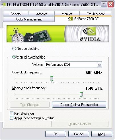

Hi, I have just installed a more up to date driver for my 7600GT, followed by Coolbits. I have gone to the clockspeed options and seen the following defaults:
The memory clock seems to be twice what it was previously. Is this dangerous & do I need to re-install something please?
It is supposed to be twice what it really is, DDR stands for double data rate, so when the ram is clocked at 500mhz, its at 1000mhz because its DDR memory and double the speed.
I have mine clocked at 605/1520 so you should be able to safely bring yours to those speeds. Mine peaks out at 666/1560 but it still runs all my games fine on the lower speeds and I prefer stability over the few extra fps.
The way the driver reports clock speed changed in recent drivers, incase you think you going mad. Also try the 100.95's at guru3d.com, they work really well with my 7600gt.
