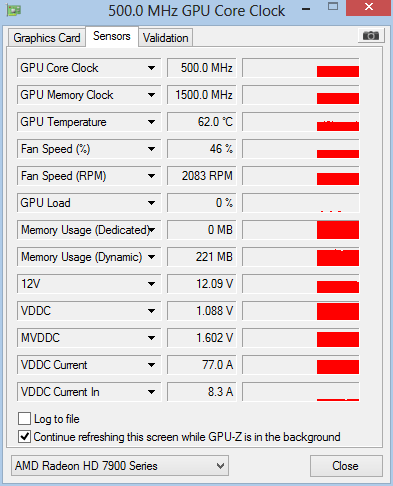

Ok from a cold boot this is how the temps and vddc current look its high to begin with and is getting higher as I leave the machine on.....
will leave it for 10 mins to see what it gets to and post back. After that I'll revert to stock clocks and see what happens..
