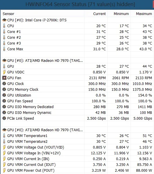

7970 @1010/1375 - 1.112v

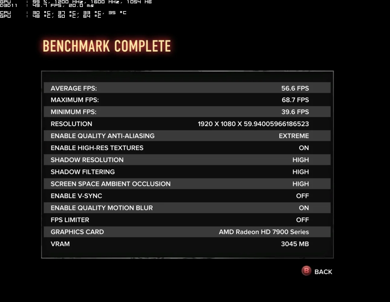

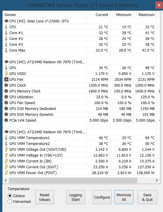

Sleeping dogs overclock run Pete
1200 core @1.155v. 1600 Memory at 1.6v.
CPU was at 4.5ghz btw for these runs.
