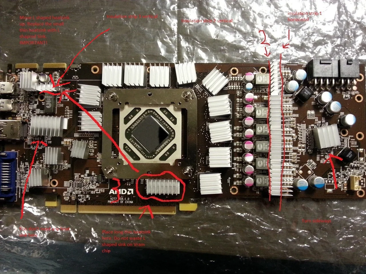

Hmm not gone well. Everything is in as instructed. When i turn PC on it turns on for half a second and just cuts out, any ideas? I tried booting without card in and boots fine
Hate to say it thats what happened to mine as you know the larger l shape sinks are to tight a fit, i did the same thing using the insulation tape and larger sinks to but when trying to start the card would only spin up for a split second and when the card was removed the pc would run fine then on the second attempt the card gave out a puff of smoke' luckily i was able to rma i then just followed the accelero guide using permanent adhesive on the vrm's which are a beter fit.
Yeah same problem as you. Damn it! (although no cloud of smoke) should have just followed the instructions with it. RMA it is then. LtMatt could you send me them pads please?
