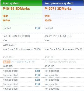

10.3 vs 9.12 (oddly my cpu score went down without changing anything, but otherwise good results gfx-wise
