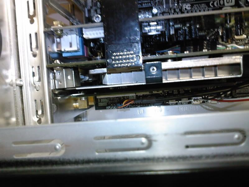

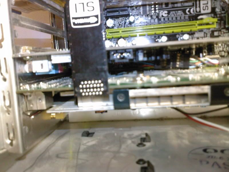

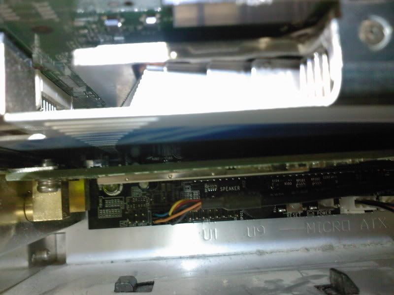

Hi there.
I'm looking to try and improve the cooling on my MSI/EVGA 800GT sli setup.
Case: Gigabyte Aurora 3d
Motherboard: XFX 780i
I'm after a 3rd party cooler that can run quietly when I'm watching DVDs etc.
Noise is not an issue when I'm gaming (the 5.1's or my headphones will see to that :) ).
The problem (as I see it) is the EVGA card is in the bottom of my case (PCI-E slot 2 is the lowest one on the motherboard). As such the airflow goes down and nowhere. Add to that the 2 PCI cards on either side of it and it starts getting restrictive in terms of usable 3rd party coolers.
I can't move either PCI card.
I was looking at a Thermalright HR-03 and mounting it so the heatsink was behind the card facing upwards but I don't think there'll be enough clearance to not interfere with the PCI card above the EVGA.
I've considered watercooling but it'd be my first foray into watercooling and I don't fancy frying my new PC as I attempt to set up a complicated loop to cool the CPU, motherboard and SLI setup.
Any ideas to an air solution?

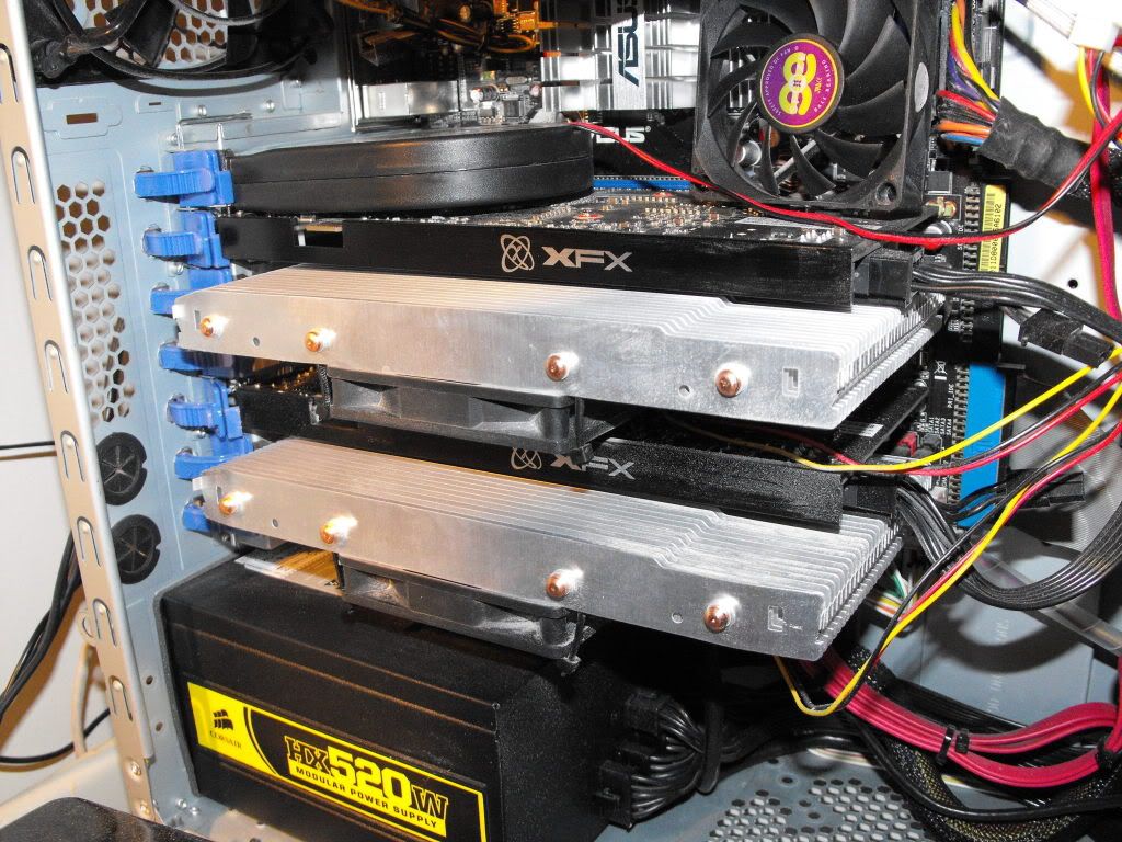

I have the same case as you, but i only have 1x 8800gt.
I found the akasa vortexx neo to be an excellent cooler vents to back of case, but
card now takes up 2 slots now. card idles at 46c and peaks at 55c.
Worth a look maybe? Don't think anyone makes a aftermarket single slot cooler.

I'll snap a photo tonight and get it up.
In the meantime here's a wonderful (¬¬) ascii representation
------------------------- (8800GT)
----- (empty PCI-E x1)
------------------------- (empty PCI-E x16)
----------------- (PCI 1)
----------------- (PCI 2)
--------------Bottom of Case---------------
I have a HR-03 on my 4850 and have just measured it.
You will need at least two and a half inches of clear space above the card and that includes the heatsink with a 90mm fan strapped to it.
You will need around 3 inches of space if the cooler is going below the card.
Here is mine. It takes up 2 PCI-E x1 and 1 PCI slot.

my current board is simular in that i cant use the 1st 2 pici slots for the xonar due to irq restriction with graphic cards
so had to use the bottom last slot and that restrict the airflow.
my temps are okay tho as they too idle low 40's and peak at mid 50's even with restrictions.
my cards are evga 8800gt ko version and i use the temperature software provided to kepp the fan at around 70% speed which keepd the noise very low.
