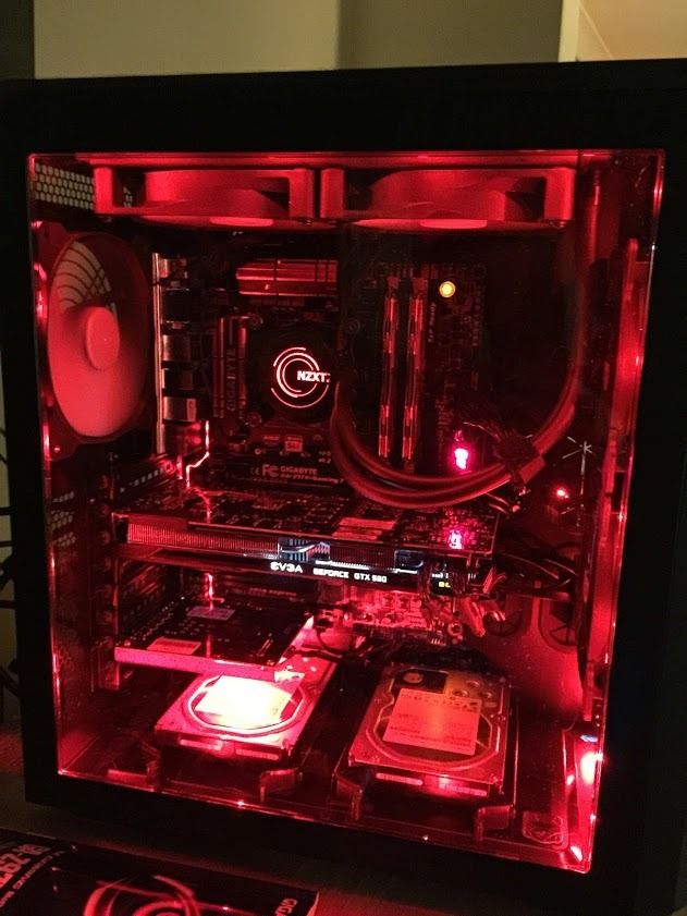

This is my two 980's - picture is a bit out of date as I've changed things round slightly but you will get the idea. The X41 on the top and the H55 on the bottom one is my plan.
The gaming 7 board has a very good gap between the primary pcie slots. Better than quite a few higher end boards from other vendors.
