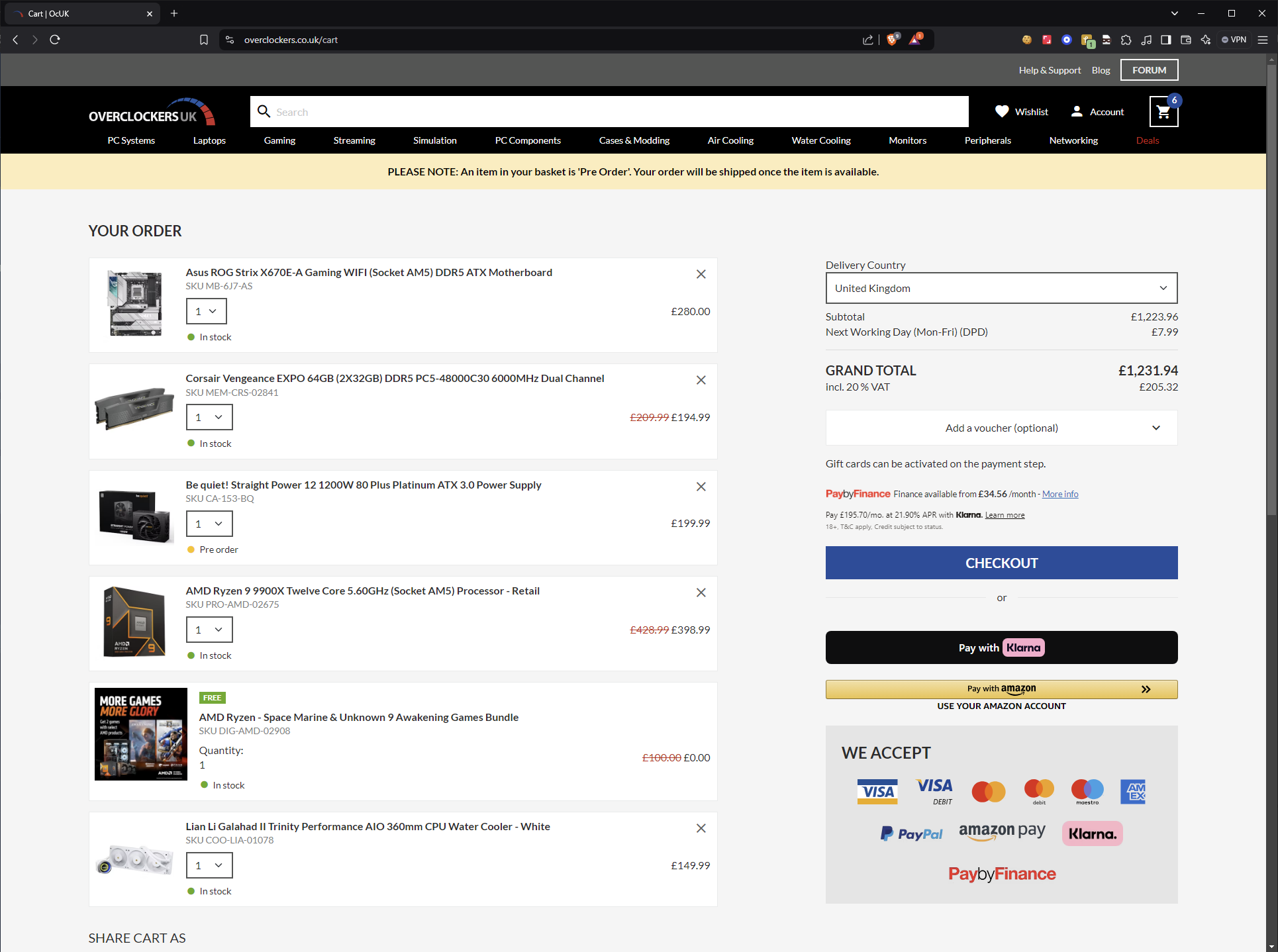

So it's that time again.... and while I'm pretty comfortable with components, I'm not too proud to admit I don't know everything and would appreciate suggestions for changing out parts for better and/or better value.
This is what I have so far (The 9900x is just a placeholder for the 9800x3d)
I'll be re-using my m.2s and my case (p400a) and for the time being my RTX3080 until the 5000s drop early next year
My main queries would be around the PSU -- I'm looking at getting the 5090 which is *rumoured* to maybe need 2x16pin connectors! so it's gotta be able to handle that. And the mobo.. I know a lot of you like the ASUS TUF but I need an optical audio out which the TUF doesn't have so I went for the ROG... but I'm open to other suggestions and if anyone can sell me on x870 over the x670?

My basket at OcUK:
Total: £990.90 (includes delivery: £7.99)​

I'm fairly set on sticking to AIO for the cooler - allows me more freedom in design to keep the heat out of the centre of the case and push it straight out, I'm fine paying the premium for that one.
Can you explain your motherboard pick for me? At a quick glance it doesn't seem like I'm really losing anything and it's cheaper -- so looks like an obviously good pick, which makes me think I'm missing something :D Pay less, get more sounds wrong in my head :P
X870 is just B650E with USB4 and an updated BIOS. X670E is a superior chipset and has more lanes available (e.g. most X670E boards have 4x M.2 slots, whereas X870 and B650E boards usually have 3).
So, sounds like I'm not really losing anything by losing those lanes given I only intend to use 2 of the m2 slots and the 16x lanes for the gpu. Right?
Yup!
