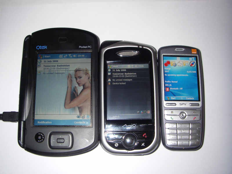

Have you considered using a PDA with GPS?
There are applications that will stamp the GPS co-ords on pictures taken with the PDA.
That option is too bulky I think. I will already have a laptop available for regular use ... So why add a PDA to the list.
