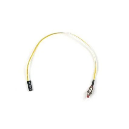

There isn't - it's the relationship of battery removal, power switched off, and the CLRTC jumper. Honestly the jumper is a good way to do it. If you're worried, buy an actual jumper header. Or even fit a little button on a wire.
So 2.54mm jumper cap? Ill grab one of these. Would love the custom jumper button. Any links to a guide showing this and whats needed? Thanks.
Still, if I get this adaptive sorted out I'll hopefully not need the darn things!
Something like this:
As you can see it's just a 2.54mm spaced female plug, wire, and a switch (button). Easy enough to make.
Or OcUK offer a set which has some:
https://www.overclockers.co.uk/lian-li-pt-sk03b-led-power-and-reset-button-kit-ca-405-ll.html
And these switches work when PSU power is disconnected? I.e Turn power supply of at back and use a screwdriver on jumpers. With this cable I could do the same but just using the switch with the PSU power off?
Exactly, it just does what the screwdriver does - connect two pins together :)
