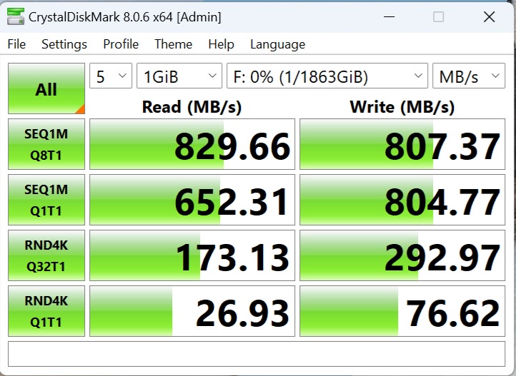

I've got a Crucial X6 2TB Portable SSD to attach to my Mac Mini when I get it, its not as fast as an NVME but still fast enough. Has a USB type-C connection. Here's the benchmark...
Cost me £101.31 on 11th December 2022. Its faster than those SATA SSDs.
