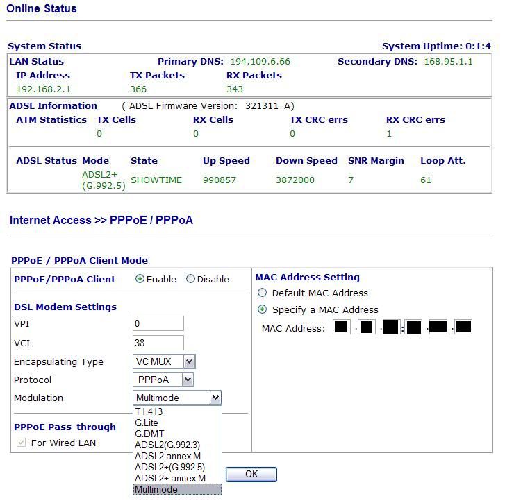

Heres some pics...
Sky Router:
Draytek Modem:

Have updated with some pics.
As you can see the connection (although it dosent say it exact, I have done a speedtest.net test) the Draytek connects at about 3-4MB. And the Sky Router is currently on 13MB! Tested that too on speedtest.
I showed the drop down menu on the Draytek pic to show the various modulation options, its set to Multimode by default.
Does this need to be changed?

Massive difference on attenuation between those modems. I'm not sure what criteria modems use to work out this figure but clearly in this case the second router Is deciding that the line is poor and only allowing a fraction of the frequencies to be used.
Something clearly wrong with it. You'd Expect maybe a single digit difference at most. For example between my Broadcom chipset modem and my non Broadcom chipset modem i get a 2 dB difference.
