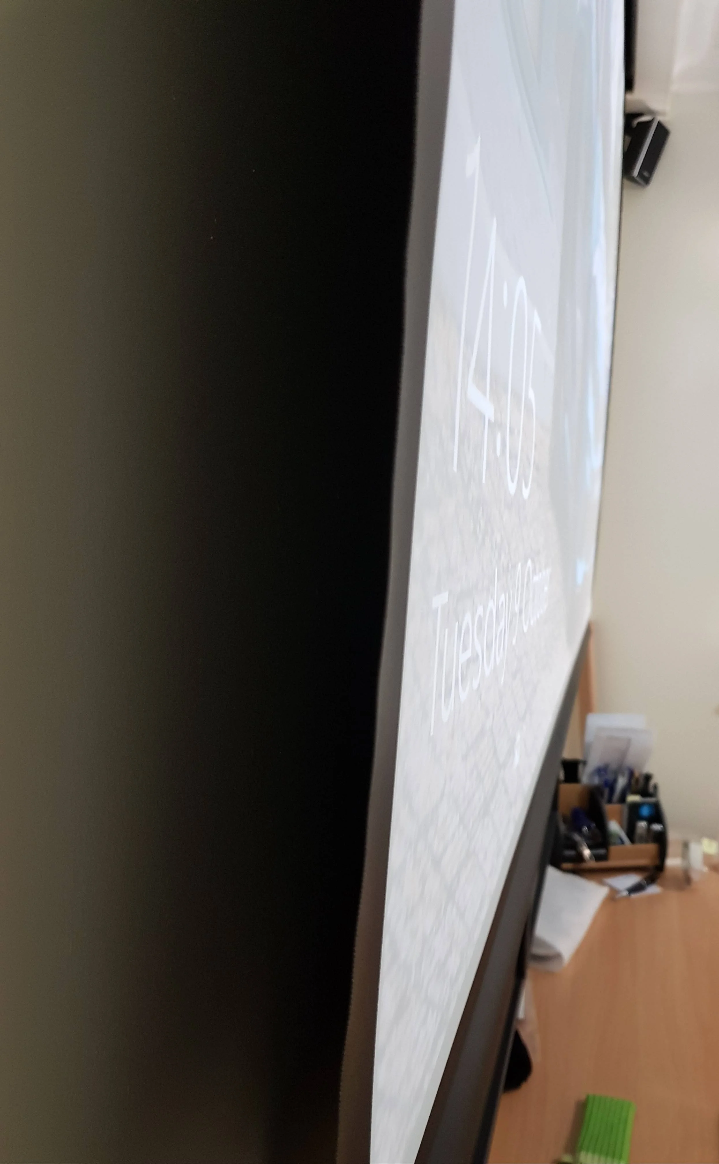

Pulling this thread back from the depths, but I would value your opinion on the Sapphire screen after a couple of years of use. Overall happy, still flat, any edge curling?
TWO YEARS?! Time really does fly!
Very happy overall still! Nothing has 'bothered me' as such, only just now as you've asked have I really paid attention to the edges. If I'm being really really fussy the absolute very edges may have curled 1mm - 2mm at most - really nothing noteworthy.
It's been great!
When it was newer, it moved a tiny bit from my preset drop, but was easy enough to adjust... It's done it since I think but is still within 5mm or so so I've just ignored it - think something like that is unavoidable really it's just natural with regards to how tight it rolls up one time to another time... but sure enough it seems to have 'settled' where it is now.
Can't comment on the remote control as I've only used it a handful of times - I just use the 12v trigger which has been flawless :)
