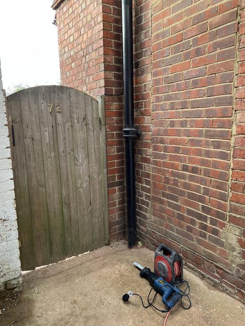

Planning to use a recip saw for the most part to cut it in to sections. Invested in a carbide tooth blade and some cutting oil for longevity.

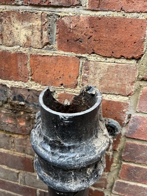

I used a recip saw with a carbide tooth blade for the first cut at the floor. I was sceptical a 4" grinder with basic Bosch metal disc would do much but to my surprise it was actually quicker and didn't really spark at all and took the lions share of the cutting around the branch which was particularly thick. Chopped the heads off any lugs holding the brackets in the walls which wouldn't pull out easily.
This piece I rocked back and forth to remove from the wall and you can see where a section broke off. Otherwise everything came out in one piece.
I left my self with this to cut off at the branch.
To finally set it free, as I couldn't cut through the bottom of the branch (saw blade was dead and grinder wouldn't reach) a few taps with a mallet and a masonry chisel in the cut I'd made and it popped off.

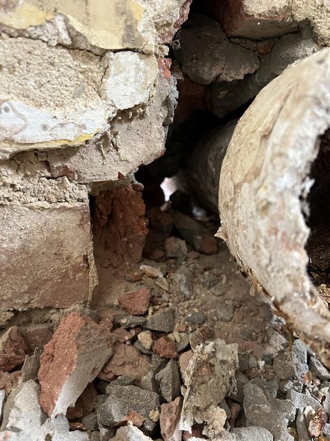

So then, inside... the extraction begun. Pretty much just used an SDS with chisel/breaker bits and then a 450mm x 8 mm drill bit to get down the sides to start to free it.
Then some gentle Russian persuasion with the mallet (being careful not to break it) and it started to come forwards out the wall.
