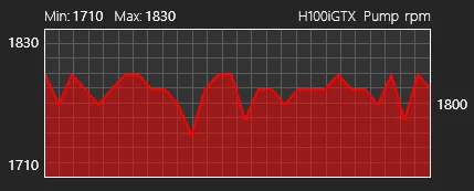

I was playing with the settings under the corsair for the pump and setting it to a higher rmp.
When I touch the pump - I can't feel anything I suppose that I should feel something. Even when changing the RPM I don't notice a change at all.

Yah I connected everything OK :). Just a did a quick prime95 now, for about 4m of running the temps stayed at 68C, which is normal, then all of a sudden after 4m it peaked straight to 100C and I switched it off. Something is not right for sure, look like a pump alright I think? Not sure what other tests I can do xD

Would spikes like these be normal when at idle?
It being broken.
