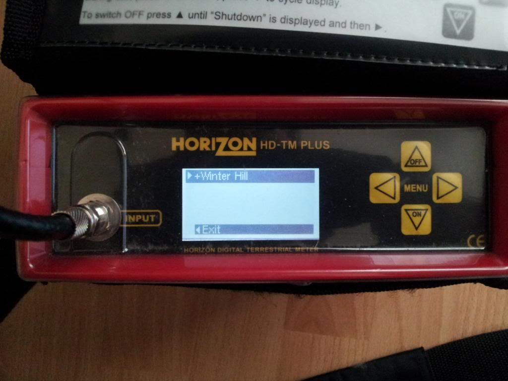

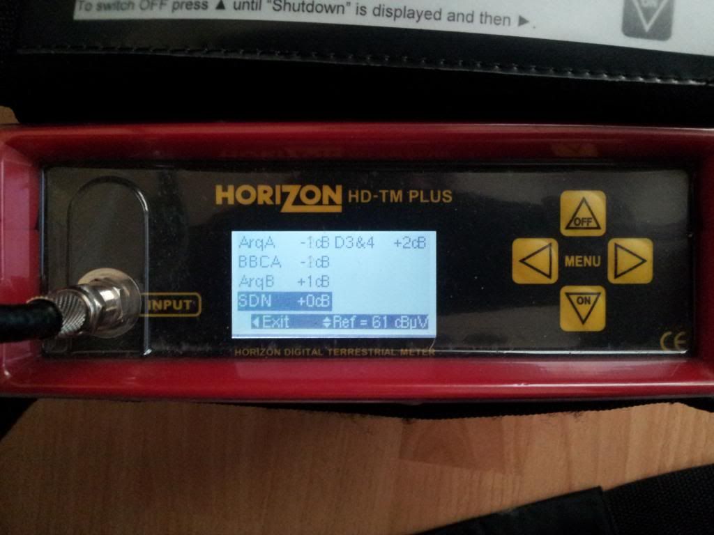

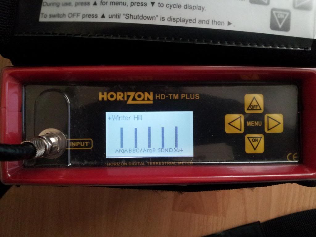

I have a Log Periodic on my roof. I use it as my reference aerial for comparing the performance of other aerials. It's unamplified and the line of sight to the transmitter is excellent. There are no trees or buildings or hills in the way. I get all the Muxes except for the very low power MEN Mux which is broadcasting to central Manchester.
The signal difference across all the received Muxes is +/- 2dB. That's really very very good. It means that there's none that are too strong or too weak relative to each other. The signal strength at my TV is an average of about 61dB, and again that's another very good result. I can afford to lose 12-16dB quite easily and still get perfect reception. In other words I could use a passive splitter and take two or three extra feeds off this signal without any issue.
