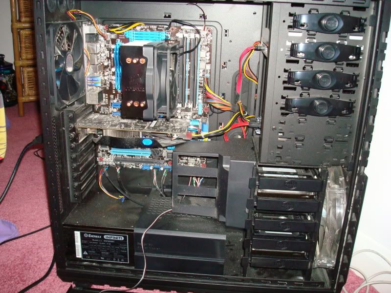

I need some advice on building a pc for my son, currently I am an alienware laptop owner previously I built my own pc's to play games the last one I built was about 5-6 yrs ago and I think it was an intel i7 cpu have posted a couple of piccys of the beast

not sure what case your going on about buddy the top piccys are my old case which is no longer mine as it got sold on
Ah I see ... I thought you still had the HAF X in the photo .... in that case the Corsair Carbide Series Air 240 gets a +1 from me ... I have had a close up look at the 240 and 540 a few weeks back and they both looked very nice cases indeed I did however favour the 540 :)
