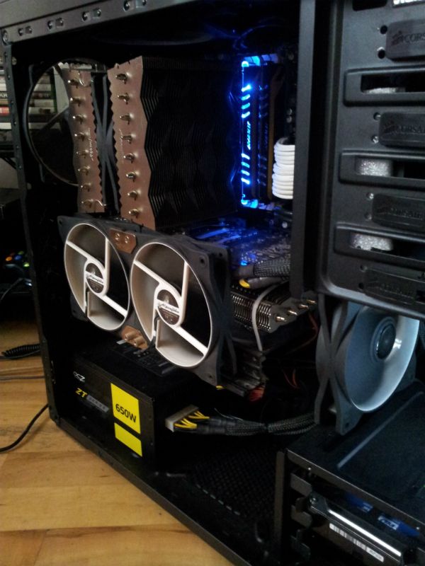

After testing with virtually every fan configuration possible, I've gone with a custom fan setup on mine; 2x92mm fans cable tied to the bottom of the heatsink, 2x120mm fans exhausting from the side (on the bracket) and 1x120mm on the HDD bay blowing onto the VRMs.
If you're into substantially lowering your VRM temps, you need to think about these kind of options. Otherwise, you may as well grab an Accelero as it'll offer about the same core temps and take up less slots in a simple, all in one unit.

Can you post a few pics of your beasty please Petey?
I need a K2 lurking at edge of photo fix :D
Certainly sir.
