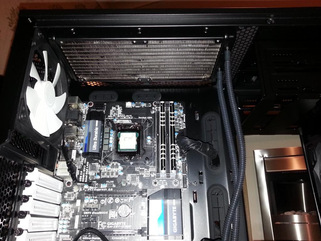

I'm finding it a bit tricky to figure out just how much space I have available at the top of my case if I were to try and fit a dual-fan AIO unit like the H100i. From the various pictures and videos I've seen, most seem to have what looks like more space between the top of the motherboard and the top of the case, where the rad+fans fit nicely.
My case has a little under 4cm (about 38mm) between the top of the case and the motherboard. Here's a dodgy picture I took:
Does anyone who has an H100i, or similar, know if I can actually fit it in there from this pic? The case is quite deep (about 20cm of usable space) ... so is there anything to stop me mounting the rad+fan assembly slightly forward from the back of the case, so if it is too deep to fit in the space above the motherboard, it can slightly overhang without touching anything (not sure if I explained that very well)?
Thanks very much!
Ori
The case is pretty wide (Fractal Define R5). It's 23cm in total, with 19cm of usable space inside (once you subtract the space behind the motherboard for cables etc).
From what I can tell, the width of something like the H100i is 12cm (120mm). Meaning I have about 7cm of wiggle-room in the width of the case ontop of that. From what I can see, I would have to move it maybe 2-3cm forward from the back of the case to avoid hitting anything on the motherboard, so I think it should work.
I assume that's something quite common that people have to do? Or am I being a bit renegade about the whole thing?
Cheers :D
Ahh, that's what I wanted to hear.
Do you have a standard size ATX motherboard? And, if so, did you just shift the radiator forward to miss any of the motherboard components?
Thanks very much,
Cheers!
Oooh, nice! Thanks for posting that. Pretty similar to what's inside mine.
The radiator does look small in there, you're right! How about the fans though, you have those on the top?
Cheers!
No the fans were mounted afterwards on the inside, still loads of clearance.
Ahh perfect, sounding more and more like a dual-fan unit might be the way to go then.

Well, I decided and it arrived today .. the Corsair H100i.
First the good new ... it's fits perfectly, plenty of space up there, and fitting it wasn't too much of a problem.
However, the bad news. When I turned the PC on after fitting the cooler, I had the side of the case open so I could see what was going on (make sure fans were spinning etc). What I actually saw was a bright flash, a little "pop" and the PC power turning off ...
.. some swearing followed ...
I checked in the location of the flash, which was where one of the fan headers on the motherboard is. The one that I plugged the "fan" connector for the H100i into, in fact. Upon closer inspection, I realized that I had managed to plug the 3-pin fan connector up a bit wonky, so that only 2 of the pins were connected and one was exposed. It seems that somehow shorted something out, causing the flash and loss of power. I figured that if I connected it properly, the problem would be solved.
Apparently not though. I made sure the fan connector was properly connected, turned it on, and nothing. Dead ... more swearing followed.
I am not sure what to do now. I checked the fuses for the power cord, but it's fine. When I switch the PSU from the "0" to "1" position, I can hear something powering up (a light whining sound), so I guess power is getting into the system somewhere. But when I press the power switch, there's nothing at all. No lights, nothing. Sometimes the case fans move a couple of millimeters, but that's it. It's like something has blown somewhere, but I don't know what!
The H100i doesn't seem to use the actual CPU fan header, so I plugged the old fan into that, just in case the PC was refusing to boot without a fan there .. but same story! Is it possible that I've fried my board just from a slightly wonky 3-pin fan connector?
Cheers!!
Oh bum ..... I think I might have found the issue (now that I've tried a different PSU, Cooler, Minimal Hardware setup, isolated motheboard etc). Then I checked the pins in the CPU "seat" and I saw this...
These are situations where having a macro lens comes in handy! I have no idea how this happened, but I am guessing that those bent pins, some of which are touching each other, are probably what's causing the PC to "NOPE" every time I try and turn it on?
Urgh .. the macro lens also makes it look MUCH bigger and easier to fix! :(
Yah .. the thermal paste somehow managed to get on there from some residue that was left on the metal surround.
Anyway, I started a post about this in a more relevant thread. End result is that I appear to need a new motherboard AND CPU!! I took my CPU to work and dropped it into 2 separate machines that I know work fine, and both showed the same symptoms as my system. Won't even attempt to power up! So it looks like whatever happened to the motherboard has somehow nuked my CPU too! Pretty much sums up my luck!
On the plus side ... I "borrowed" a motherboard and an i5 from work to keep me running until I get something new, and the H100i is doing a great job!! Sitting at least 10-15 degrees cooler than with my (very good) BeQuiet cooler. Although not really a valid comparison with a different CPU and motherboard :p
