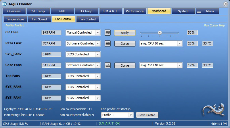

No, I left it as is but it's fairly easy to do (from what I recall). If you don't like the fans ramping with the pump then it might make sense to do that and have separate curves.
I just see that, for the 420, the fan speeds are easy enough to control via software.....
50%.............
or 100%....
or then with a created fan curve, with the pump looking after itself. I have mine set with a fan curve for both the fans and the pump.
From what I understand the RPM value is taken from the first fan.
In typical use, so far, the 3x140mm fans are pretty quiet.

For the Arctic Freezer, all fans are connected in daisy chain. The first one connected to the pump.
You only have to disconnect the first, use a common 4 pin fan extension and control the fans as you wish, but to be fair, mine was 50% when CPU up tp 60C, 60% when CPU up to 70C and a blast 100% when CPU over 75C.
