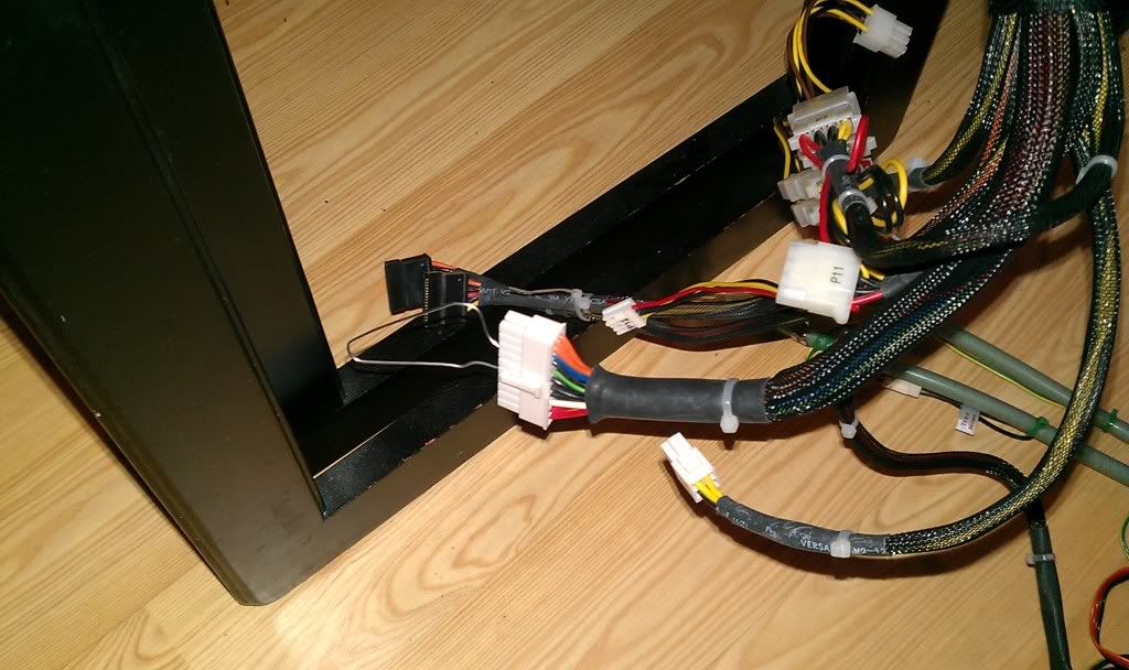

For turning pump on and off why not just jump the psu? Unplug everything except the pump and on the 24 pin cable connect the green wire to any of the blacks. Personally i use and old piece if wire but as soon as connection is made pump will run then unplug and it stops. No needto boot
pc for that.
As for res same level as the pump, i presume the water level is higher than the pump meaning the pump is still being mavity fed? In which case pulsing the pump or leaving it running for a bit has removed all the air locks from my pump tops.
pc for that.

jumping the psu can be done to test as in
but if you a bit concerned then dont tbh

edit: you should always leak test without the hardware powered, inside the case. You can buy an ocuk psu bridging kit for a few quid, just plugs into your 24 pin.
alternatively you can buy the 90w version of the phobya external 4 pin molex psu and use it for leak testing. Ocuk don't sell this.

Disconnect ALL other connectors from PSU apart from Pump power when you test the loop for leaks.
