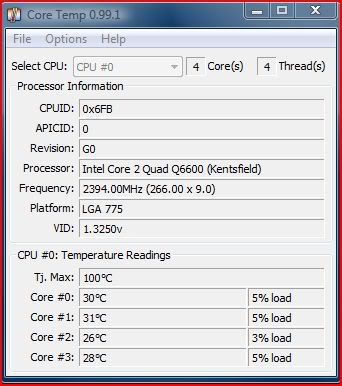

I got this case of these forums about 4 months back, great case, love it to bits.
Though I do wish i could improve air flow abit.
Normally all cores on my Q6600 idle around 40 deg, I'm sat here at the moment with the side of as I've just spaced my hard drives out to improve things a little. QWhilst doing this I've left the side off to compare temps and my cores are...
