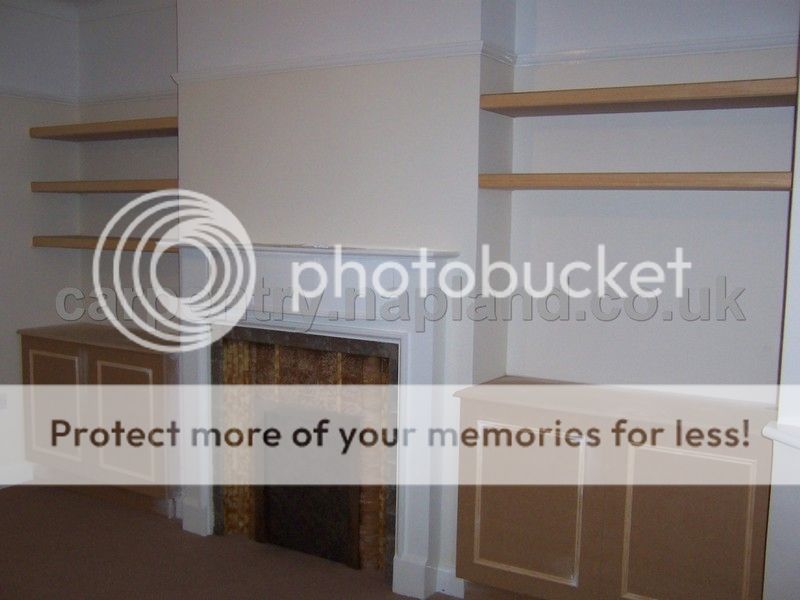

This is almost exactly what I want to do and how I'd like ti to look (though I'd like a slightly different colour wood finish)

Essentially I'm looking to make something like the pic I posted earlier. I was thinking nice thick wooden shelves and then cupboard made up of 2x1 frame work faced up with timber boarding, with the doors also made from the timber board with some routed detailing on them. The top surface also I'd like to be nice solid wood too.
