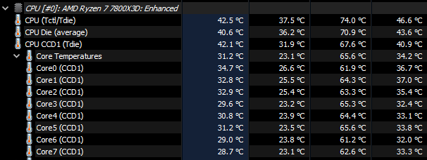

Can you post a pic as I see lower temps on the individual cores compared to CPU Tctl/Tdie but by 10C not 40C :p

from what i can see temps actually look very good, i suspect that when windows has a background task its hitting the cpu which is why your seeing temp spikes, out of intrest in hwinfo64 how many cores are being loaded up in starfield, my 7950x on average is using 12-13 cores, i also play at 4k ultra but uncapped and get around 80-100fps in game.
do you have a lot of programs starting up with windows, maybe a couple of them are hitting the cpu hard, if not have a look at your thermal paste application, core 0,1 and 2 are pretty warm tbh if idle, the rest are all spot on.

In hwinfo all 8 cores are loaded up during the game. My fps is capped to 60 because I’m using a 60hz TV as a monitor. I shouldn’t have any program’s starting up with windows as it’s a fresh install. I use a Mac normally and game on the PS5 so I built this rig to play Starfield basically, hence why it’s plugged into a TV.
