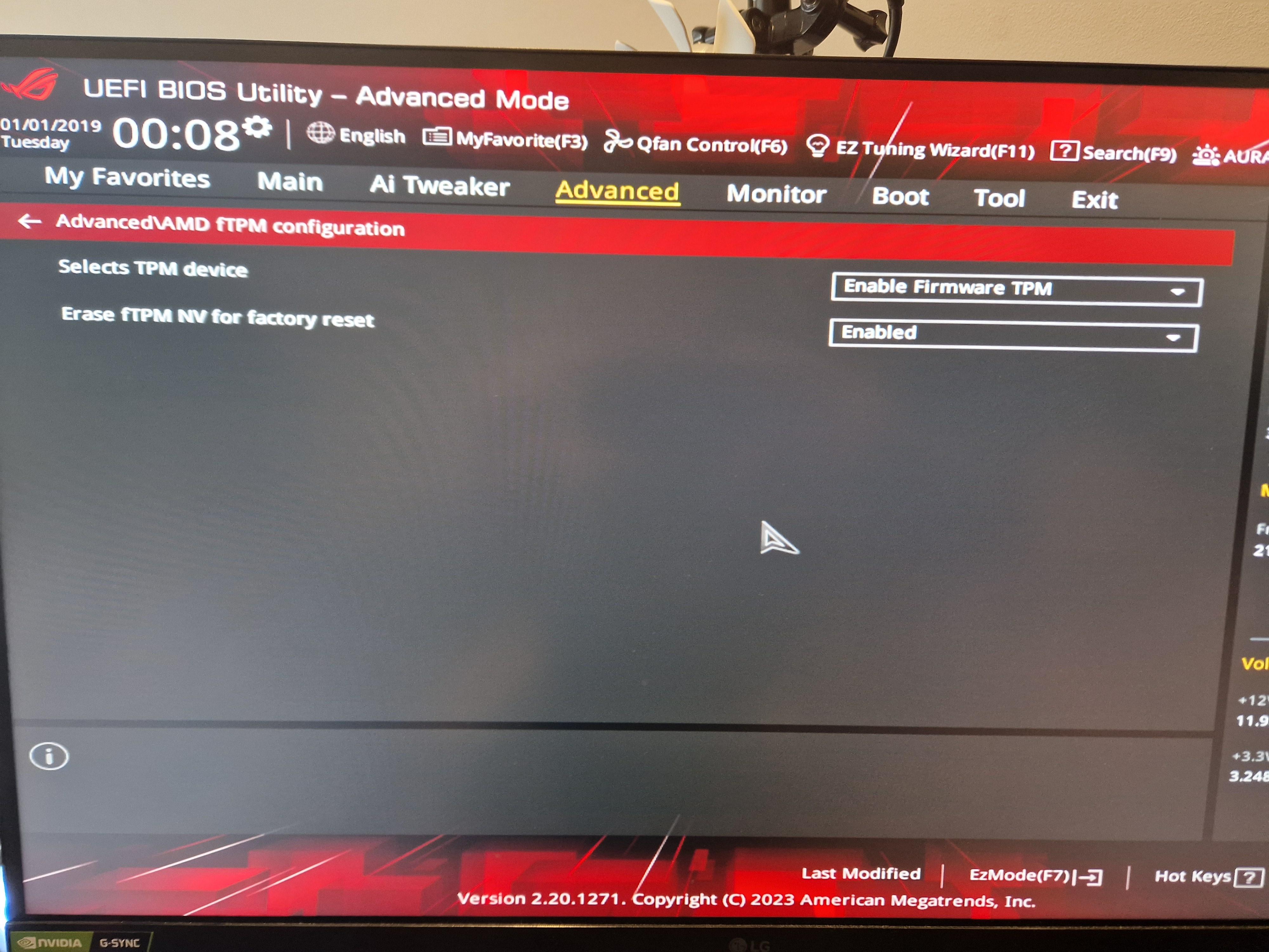

I've got these options here, this is how it is by default.
Tried the CSM and disabling the various AMD FTPM settings but nothing seemed to work. Eventuslly managed to get it sorted by just clearing the CMOS in the end. What a stupid pointless Bios setting.
Erase fTPM NV for factory reset to disabled (Always)
A Bios flash resets your bios to defaults, you have basically reset your fTPM ddata.
