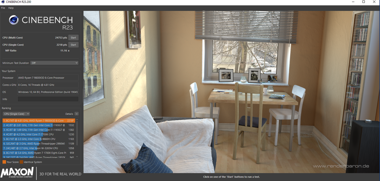

5.5ghz at -30 CO 1x scaler

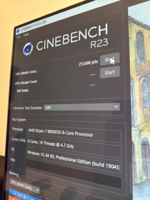

Not bad, you must have a decent chip. I don't have the full screenshot to hand atm, but the best I've achieved so far is...
That was running a 5.575Ghz at 1.21v. CB23 is really hard on these CPUs, so I don't plan to go any higher on voltages on this bench.
Yeah I think mine was running the around the same voltage. Was that score from a clean/minimal install?
It was running on Win 11. Windows doesn't really make any difference. What will help most is low temperatures and setting CB23 priority to realtime. That may net you another 100+ points or so.
