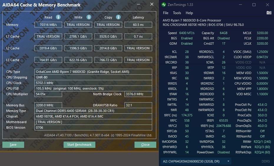

At the moment I'm running Karhu Ram Test, only a couple of hours in, but can anyone comment on my ram timings please?
I wont pretend i know anything about them, I've mostly tweaked them in-line with Buildzoids YouTube channel... I can do tighter timings at 6200MT/s (30, 36, 36, 28 from the primaries) but I'm wondering if anyone can see any further gains I can get.
I've noticed that I don't need to increase DDR voltages to achieve 6600 1:1, although its not stable in windows apart from the odd bench.
