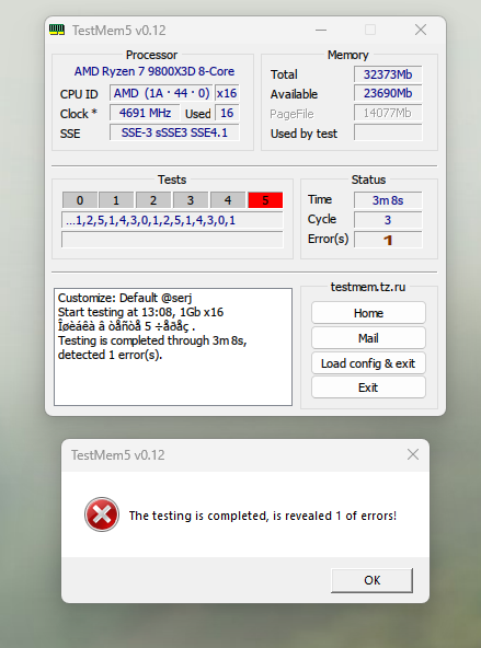

OK, I've just run TestMem5 and it's reported an error...
I'll try the Windows memory tester, but I guess it's RMA time?
Edit - Windows memory Diagnostic ran fine…
