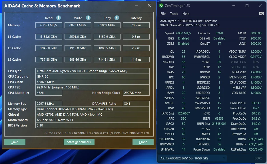

@Cenuij this is what I've ended up with... basically stock EXPO with a few Buildzoid settings and decreasing tRFC as you recommended.
Not great, but I'm only gaming so I'm sure it's fine. I did get away with the -35 curve optimiser and some people can't do -20, so there's that I guess :o :( :p
70ns in Aida is probably what I would expect from my own experience using that tool @6000
Have you tried 6200 with 2066 FCLK? 6200 is not too hard, and 2066 aligns nicely at 3:2
Edit: I guess also disabling gear down mode might eek out a little bit more performance, and then disabling bank address hashing would probably boost write speeds a bit.

Shouldn't your FCLK be 2133 with 6400 memory in order to have the optimal FCLK to UCLK(MemCLK) ratio of 2:3? That would improve latency no? Or is even higher FCLK better? I guess you could benchmark both and see what is faster
I said something similar earlier in the thread before I tested it myself.
In reality, I’ve found that in 1:1 mode (that’s, MCLK:UCLK) higher FCLK improves latency. This is because, I assume, a ratio of 2:3 UCLK:FCLK doesn’t really have any major advantage.
However, I understand that in 2:1 mode, for higher ram speeds, then it does matter. E.g 8000 speed ram, 4000 MCLK, 2000 UCLK, 2000FCLK.

Oh really? On Auto my FLCK was 2100, I dropped it to 2000 for a 1:2 ratio after reading that was the thing to do... :(
But what ram speed are you running? 6000 needs FCLK 2000, UCLK and MemCLK 3000. 6400 needs FCLK 2133, UCLK and MemCLK 3200.
If your FCLK was stable at 2100 you could run your RAM at 6200 with 3100 UCLK and MemCLK. Either way the benefit in games is 1-2% going from 6000 to 6400 so for me I decided it was not worth the hassle. But this is OCUK so people enjoy tuning and tweaking which is cool if they are having fun
I have not kept up with it, but isn't 2:3 fclk:mclk thing a myth? Benchmarks favored fclk to be as high as it goes, and couple cases where fclk wasn't really stable at high speeds made people think dropping it to be 2:3 was an improvement?
This is what I’m saying is NOT necessary.
With 6000 ram speed (MCLK 3000) and UCLK of 3000 (i.e. 1:1 mode), there is (in my experience) slightly less latency with FCLK being higher, regardless of ratio.
The big gains come in 2:1 mode because your FCLK matches UCLK.
