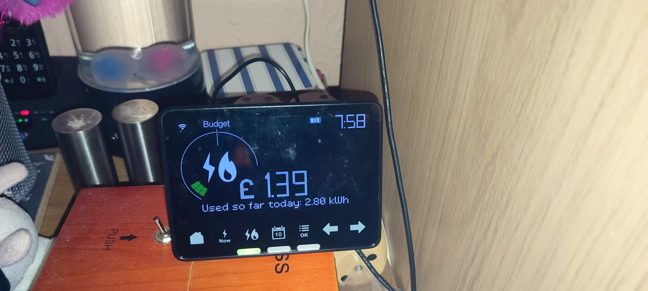

The day after the gas meter change...........not showing on the IHD nor the energy hub.
I am assuming as this is a replacement meter it should just work.?
